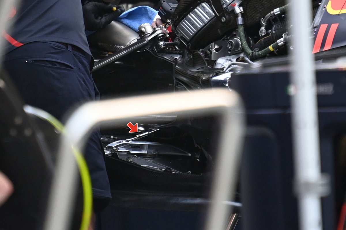

I was looking at this pic from another thread, it's the internal floor stay from the RB18.
Obviously the tube above has some length adjustment but does anyone know what the purpose of the machined billet piece underneath is? Just looks quite complex is all...

clownfish wrote:
19 Aug 2022, 14:38
https://i.postimg.cc/J7JdXgC7/XnnLnGwo.jpg
That's a structural spar that supports the floor. IMO that's why they went with the wide sloped sidepod design--to have smooth bodywork over these robust floor supports. Which no other teams except maybe AT started the season with.

clownfish wrote:
19 Aug 2022, 14:38
Does that loo like it is intended to move? (more than just under adjustment)

It does look a bit like a miniature shock absorber.

Sieper wrote:
19 Aug 2022, 21:16
Looks like a turnbuckle, and that is also what you would expect to be there.

Could be a turnbuckle to alter height of the floor for fine tuning any downforce at the rear.

Sieper wrote:
19 Aug 2022, 21:16
I mean more the way the metal carrier is mounted. It looks like it pivots, and what is the slot* in the 'arm'?
I know it would have to move when the rod is adjusted, but it seems elaborate to just be for an occasional adjustment when you consider cost and weight.
Difficult to see how the inner point is mounted though
Edit * Actually now I see it on a larger screen it may be a label rather than a slot. must get my eyes tested. :cry:

TimW wrote:
19 Aug 2022, 21:33
Sieper wrote:
19 Aug 2022, 21:16
The fact that the length on the female connector is longer than the exposed threads on the rose joint gives credence to a hydraulic compnent...🤔

….or an encapsulated spring?

Zynerji wrote:
21 Aug 2022, 02:34
TimW wrote:
19 Aug 2022, 21:33
Sieper wrote:
19 Aug 2022, 21:16
When you tighten a turnbuckle the thread disappears. A fully tightened turnbuckle will have no threads exposed.
But given that the turnbuckle has threads on both sides(right handed one side, left handed on the other) and you also need a length of thread engaged in the nut on both sides, this is probably near its maximum extension.
