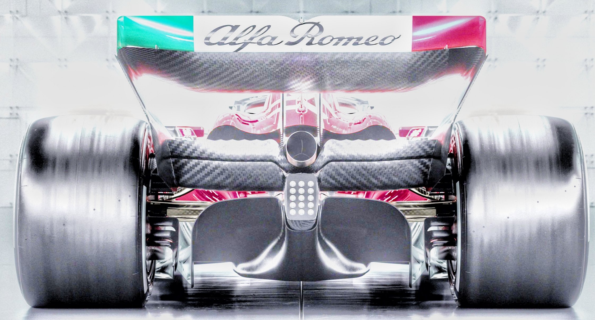

A few more pics:
Pics from Alfa Romeo Twitter feed:

Interesting split inside exhaust. Has a twist
