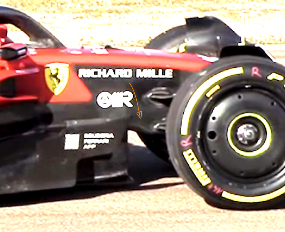

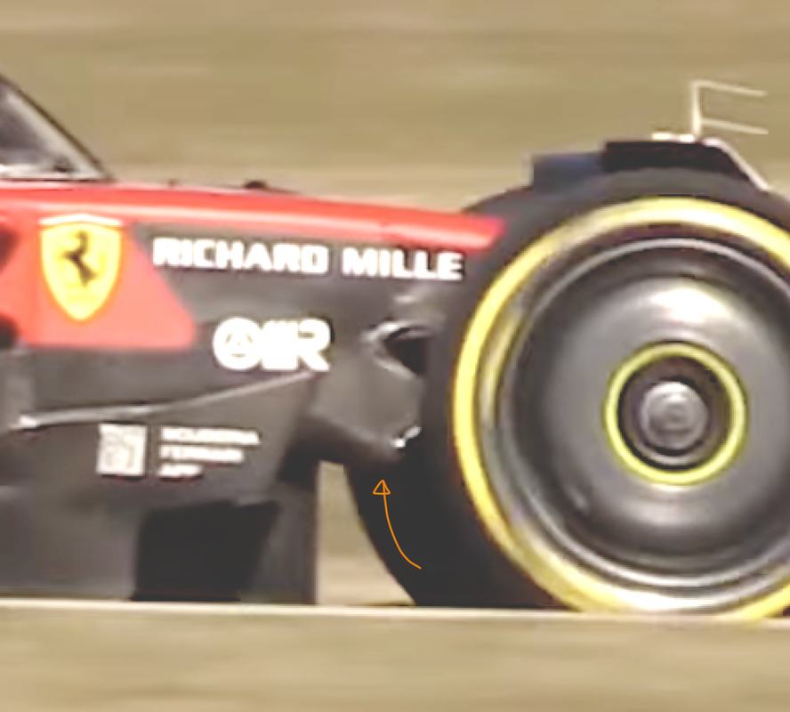

gordonthegun
254
Joined: 28 Mar 2019, 23:33
Location: Monza, Italy.
Re: Ferrari SF23
Change in rear brakes cooling intake:
