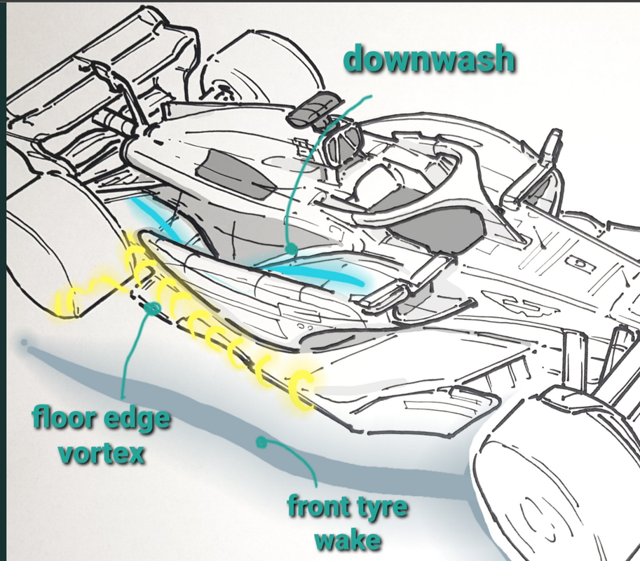

Re: Aston Martin AMR23
19 Feb 2023, 23:56
I was quite surprised that Craig Scarborough released this inaccurate sketch after the launch. It looks nothing like the car in the sidepod area.
Williams already scraped such an extreme departure angle of the sidepod. I'm sure the flow separates.
https://i.postimg.cc/g2HXc5p4/image.png
I don't think it's inaccurate, scarbs often uses photos and overlays drawings. I think the waterslide keeps the flow attached and I'm sure the team checked the behaviour in all adverse conditions.
What AMR could be doing with this extreme waterslide is inducing strong lift on top and trade it for massive downwash aimed at beam wing and possibly even the whole rear wing, something like Merc is doing with mid wing but placed inward. It would provide more clean air for both as well as increase the induced angle of attack. I'm really liking all the solutions of AMR23.
Blackout wrote:
19 Feb 2023, 23:35
If you look at the rear view studio picture, the waterslide never meets the floor before diffuser area. it goes up again, then down...
https://i.imgur.com/yal43Gw.jpg
Refer to this image. Scarbs depiction doesn’t look anything like this.
The water slides don’t go to the floor in the middle of the car.
Vanja #66 wrote:
21 Feb 2023, 09:40
19 Feb 2023, 23:56
Maybe with the steel angle of the ramp (contained within the fences of side pod and engine) behind the inlet they are able to swirl the air, energizes it and feeds the beam with with more air than a simple ramp.
1802
FW17 wrote:
21 Feb 2023, 09:55
https://images.all-free-download.com/im ... _16789.jpg
That's not really what happens, I can assure you :D That would mean loads of turbulence and losses, the air doesn't behave like that. Water maybe would, due to 800x higher density and 800x stronger inertial forces.
21 Feb 2023, 09:44
This is scarb's original post
You can see the photo he took as reference. :)
Vanja #66 wrote:
21 Feb 2023, 10:00
21 Feb 2023, 09:44
Okay I see I was fooled by the fake renders that AM released.
