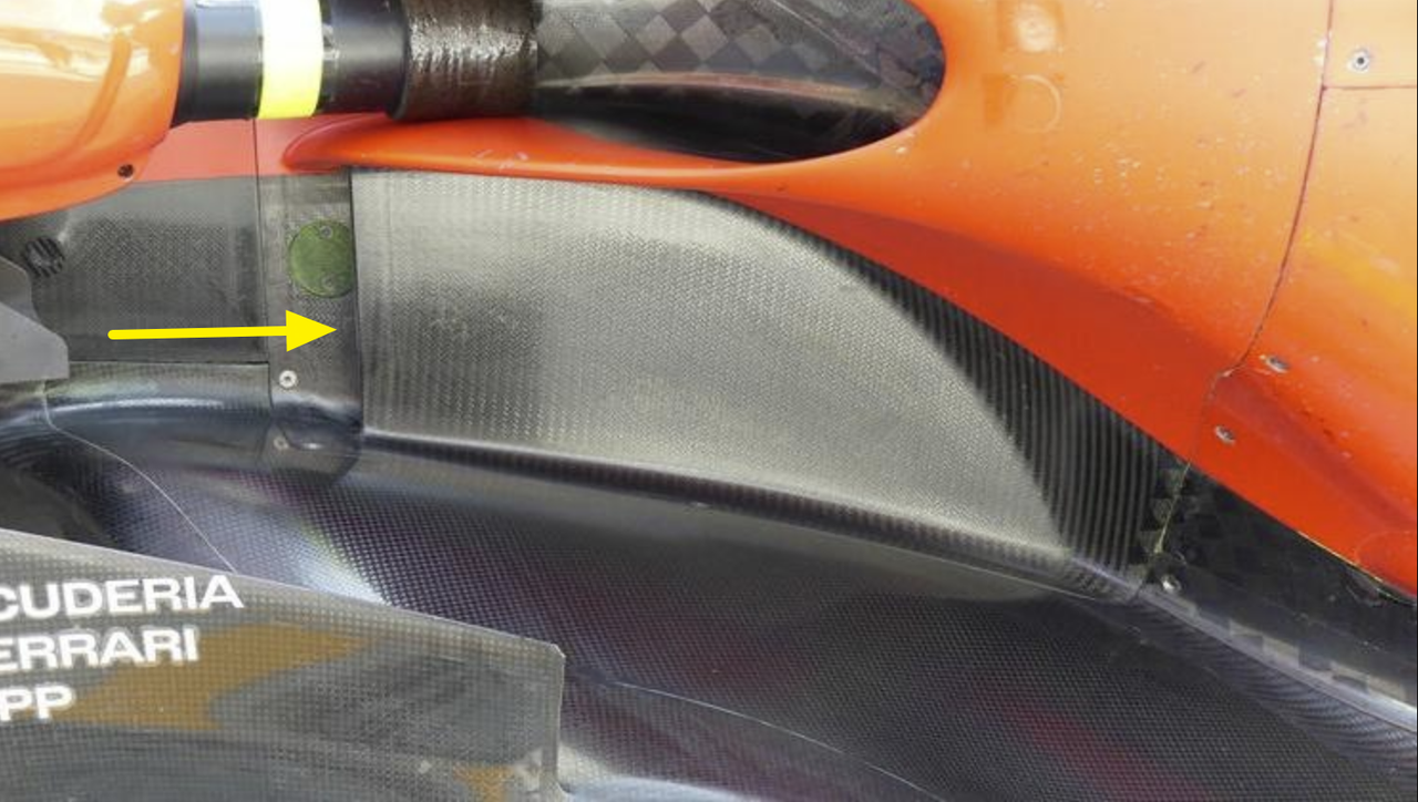

I have a question, the "Sidepod duct" was open or was covered during the tests?
Edit: Okay, I just saw the post about that, my bad :lol:

Re: Ferrari SF23
26 Feb 2023, 17:18
https://i.postimg.cc/fRkLhfzm/image.png
Can't neccessarily see if it's open or closed, but the duct still looks present.
Just posting
1802
Re: Ferrari SF23
It won't be closed off, it's an important duct for flow around engine cover and extracting hot air through the louvres.
