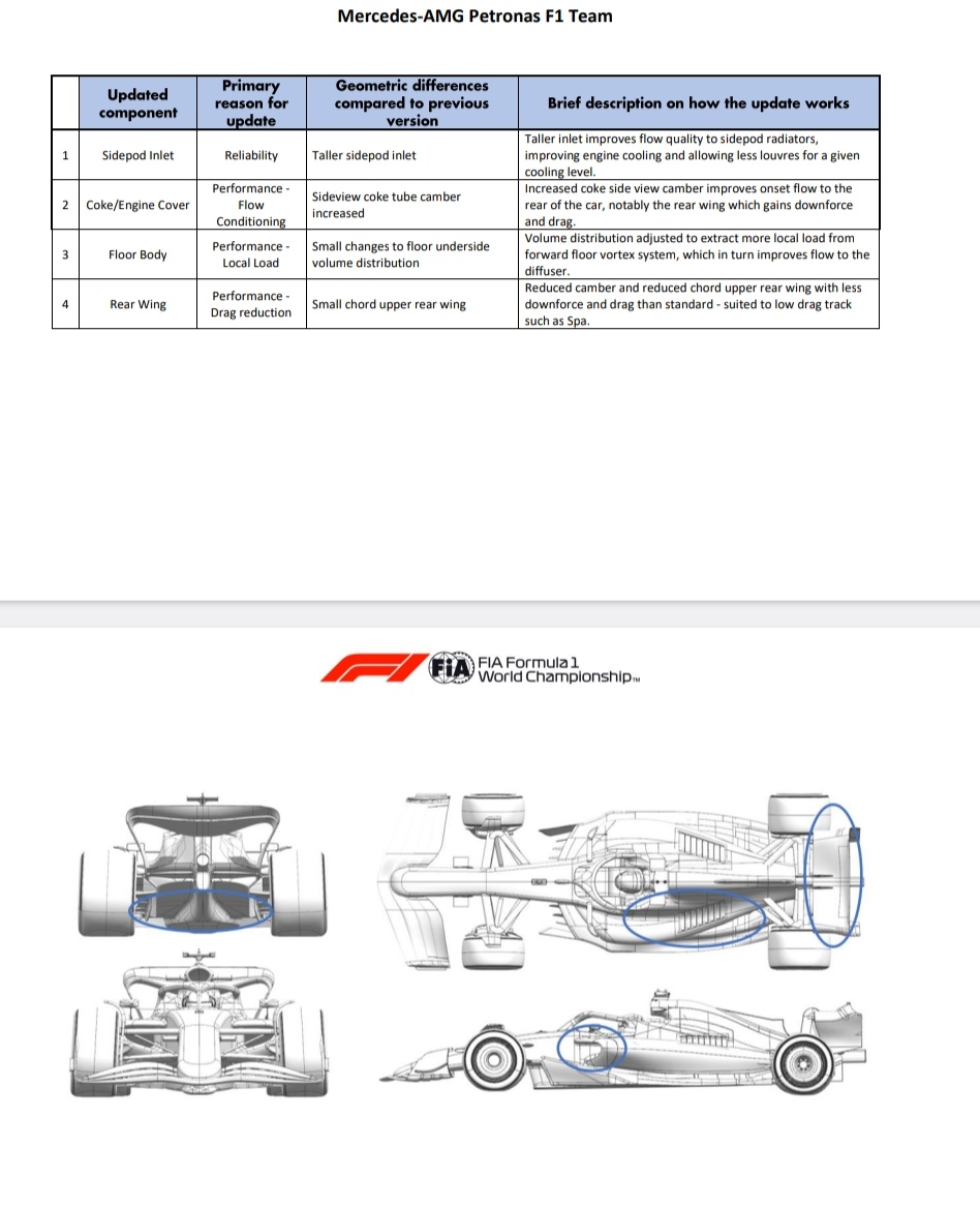

Re: Mercedes W14
214270 wrote:
28 Jul 2023, 12:41
Same with the front:
No. Says rear.
Puffpirat
Puffpirat
Joined: 19 Jul 2022, 00:18
Re: Mercedes W14
Cs98 wrote:
28 Jul 2023, 13:11
214270 wrote:
28 Jul 2023, 12:41
No. Says rear.
Look at the front wing upper flaps. Lewis‘ is trimmed
Owen.C93
Owen.C93
191
Joined: 24 Jul 2010, 17:52
Re: Mercedes W14
They’ve run it before so won’t show up on the update sheet.
