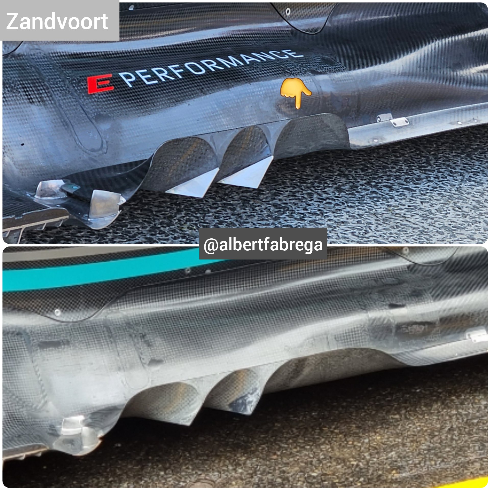

1. Reduced span forward floor edge wing for performance (flow conditioning).
Offloads the floor edge wing a little, which in turn reduces losses improving flow to the rear and increasing rear downforce.
2. Decambered inboard mirror stay on the side pod inlet for performance (flow conditioning).
Improved robustness of mirror stay through all conditions, improving flow quality to the rear of the car and increasing rear wing load.
3. Increased element camber and chord on the beam wing for performance (local load).
Increased element camber and chord increases beam wing local downforce (and drag) which in turn increases the rear floor load.
- per Mercedes
