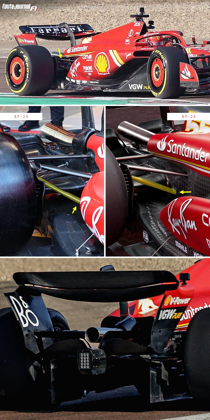

Most decisions made for the SF-24 make perfect sense, except keeping the rear as pullrod.
Ferrari raised where the rod connects with the chassis compared to 23, you know what also would've raised the rod way higher, a pushrod...
I don't expect it to be a night and day difference, it's just one rod, Ferrari did it's best to minimize the "penalty" and the suspension arms still act as obstruction of that area to every team, but the other solution just makes way more sense.

Sevach wrote:
16 Feb 2024, 21:12
I don't expect it to be a night and day difference, it's just one rod Ferrari did it's best to minimize the "penalty" and the suspension arms still act as obstruction to every team, but the other solution just makes way more sense.
And the chassis won't be changed for next year so they are stuck with pull rod in 2025 too

Sevach wrote:
16 Feb 2024, 21:12
It does not makes sense to switch to push rod rear with 2 years left in this regs cycle in my opinion. You'd be better off making compromises and focusing on bigger deficiencies. Then decide whether it is worth a change in 2026. Cardile himself said there were indeed aero benefits to using push rod rear but the added weight and lack of compliance was not worth it for them. If they can optimize the weight and work on compliance over the next 2 seasons, a switch in 2026 makes more sense, given it is still way to go.
Both Allson and Harman admitted the redesgin of the chassis and gearbox took up way too many recources and slowed the development rate down a lot.

scuderiabrandon wrote:
16 Feb 2024, 21:49
Sevach wrote:
16 Feb 2024, 21:12
To me it doesn't make sense because Ferrari went and changed the gearbox casing anyway. Why would you fiddle with the gearbox casing, and then not make the switch at that point.
To me Ferrari just gave PR excuses. I get it though. They had so many things they wanted to work on and there was a risk they could get lost with the change. They stuck to what they know rather than the unknown. That in of itself is a positive spin, but I suspect in a different more unlimited timeline they would have a push rod.

The SF 23 was not a slow car last year, beating the RB on pure pace more than any other entrant.
Don't think they maximised it in competition, took some considerable time to understand how to get out of TD039 predicament, ultimately until last iteration of the floor etc toward the end of 2023.
Looked like they were still "stroking" PU software in combating 2022 mechanical reliability issues during initial phase of 23 too.
Pure and absolute pace was generally close to RB.....their own assessment seemed to intelligently, and with diligence, list and target primary areas of concern that they appeared to have verified quite thoroughly during 2023.
Sidepod and associated aero map, plus optimisation of rear suspension that they acknowledged was good (concern seems to be solely underfloor aero impact/volume) looks to be a very very solid development in evolving their car.
Casual observance of "why haven't they gone pushrod " seems a very crude and naive analysis by way of determination and projection of performance that we've all yet to see.
They seem set to offer the most evolved challenge they can to RB, I feel there is good room for more optimistic expectation.
