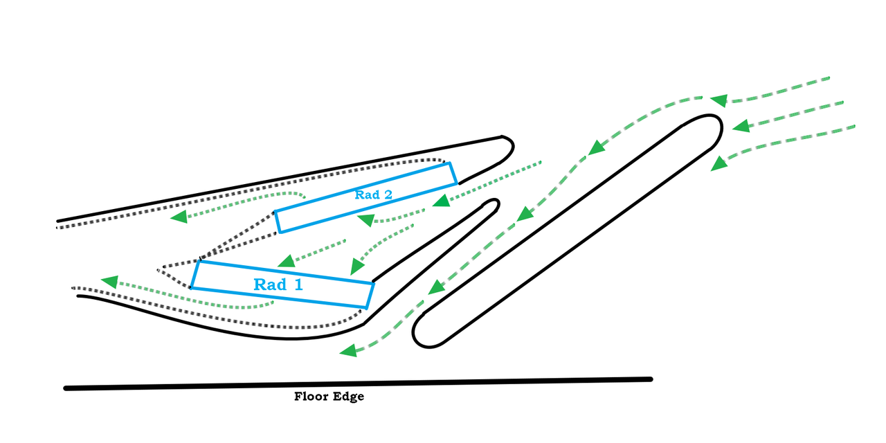

It's like a double downwash concept. I like it. However I can't see where the inlet would go or how this would make sense. The only scheme I could think of was this, which I don't think is legal.
I don't think this is legal because of the number of sections which are intersected in the X-Z plane containing the inlet. There's 3 in a section of this concept. The regulations permit a maximum of 2. Also, rarely are you permitted to place a random wing shaped bit in the middle of a car. Something like this just makes too much of a mockery of the rules. The two section rule doesn't let you do anything interesting with the sidepods except take a traditional shape and make it smaller.
