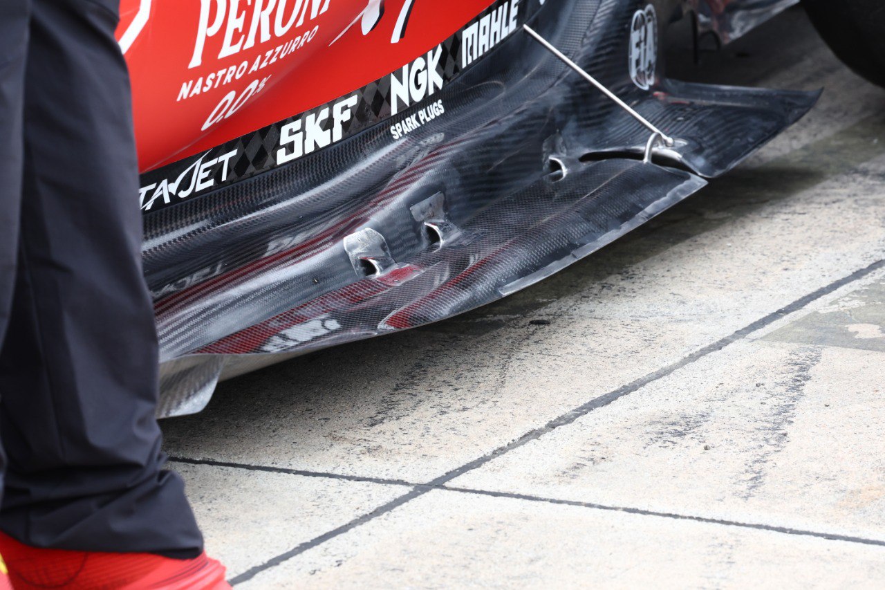

The floor edge is very big. The hingers are deep in towards the side pods. Not new but I just noticed how much of the floor is the floor blade.
What they have done now is make this a very independent piece of the floor by adding the goose neck supportat the rear.
The floor edge can ride on the ground and still have enough air gap between it and the main floor to prevent stall. The steel gooseneck hinges if you will can also take a lot of hammering over curbs and not distort the whole floor. Just rhe floor edge will ride the ground or curb and hinge upward or have some compliance; since im sure the supports arent moving hinges (the will allow movement though).
