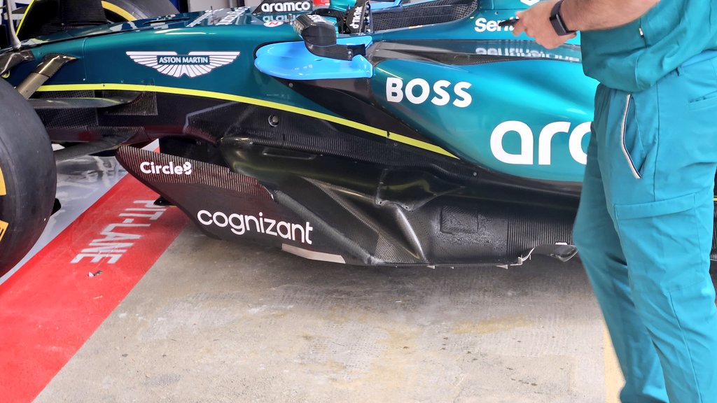

jrdls wrote:
25 May 2024, 04:27
Any signs of flow separation? I don't trust my judgement.
yep - but at Monaco that's not a disastrous thing, you can have a surprising amount of separation on a wing before it's at peak downforce. It's just quite draggy.
How I read it - and it'd be easier under a UV light - if you look at the wing you see a thin band on the flap where there doesn't look to be any flowvis - this is the transition bubble between laminar and turbulent flow regimes. Then the flowvis gets a bit speckly but still has striations - that's turbulent. Finally mid-way up the sponsor there's another thin band where the recirculation has settled the paint a bit then it's whispy and speckly but no longer has linear striations - also behind the centreline and the DRS actuator there's a V of loss.

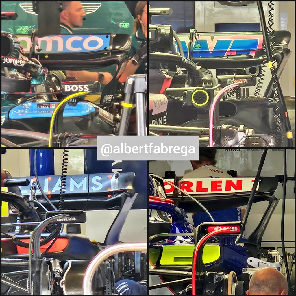

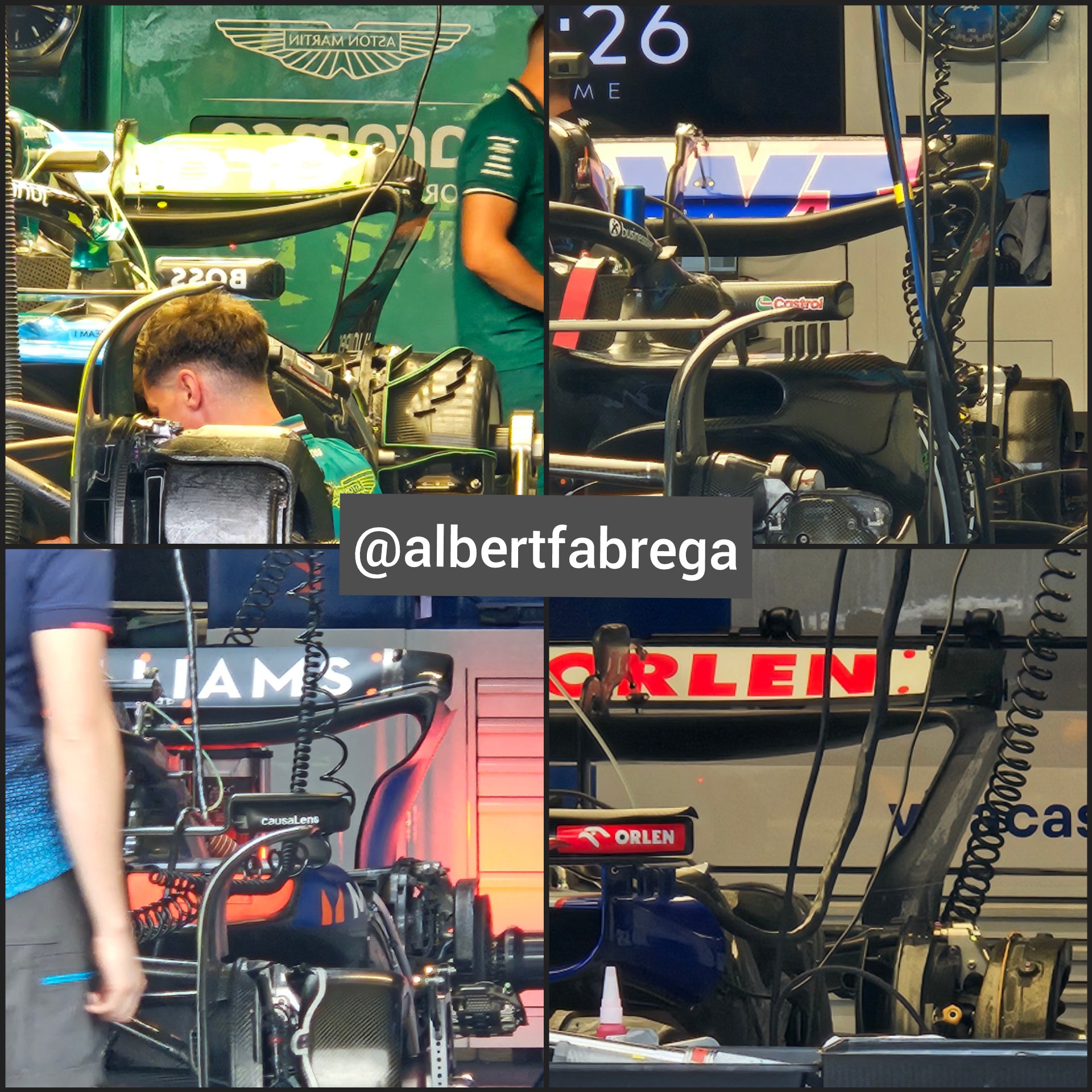

New engine cover fin.
Ashwinv16
60
Joined: 15 Jul 2017, 12:04
Re: Aston Martin AMR24

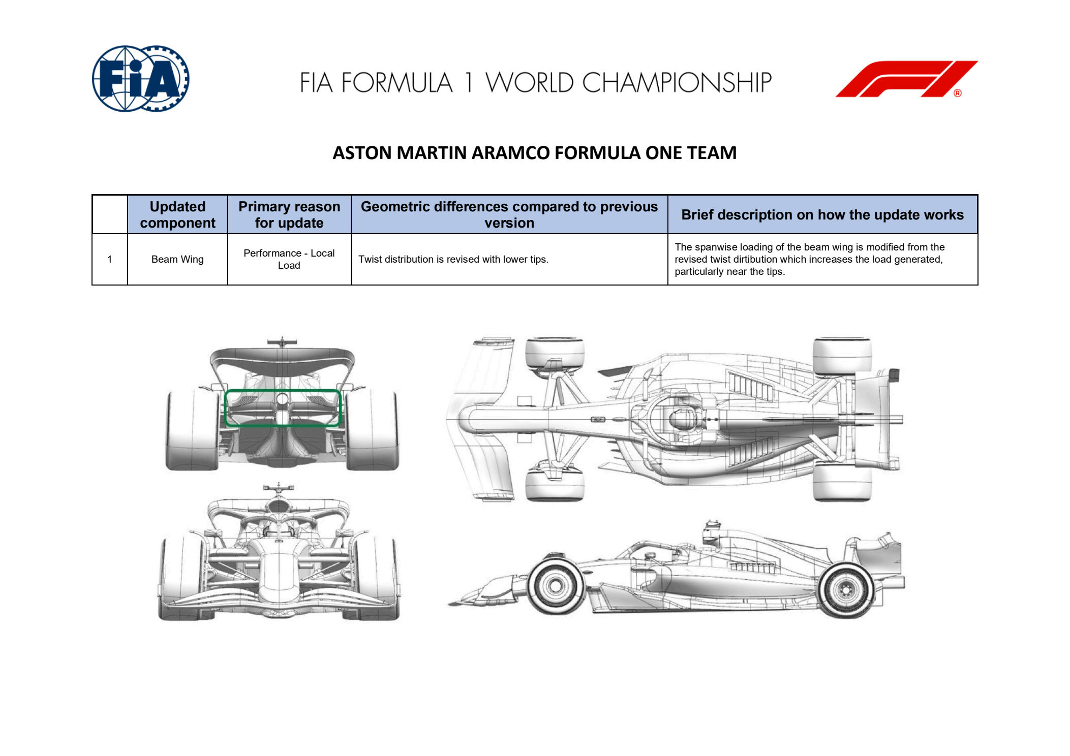

New Beam Wing and likely underfloor (beam wing now more surface area than the one in Monaco, but with more gradual of angle of attack(so less loaded)) (New rear wing hidden? (old wing in garrage)
Not sure if there are changer anywhere else
Halo not as bad as we thought
