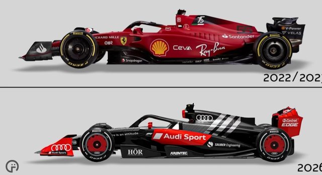

Keeping in mind that these are not the final regs, I think these regs are a decent solution to a tough problem. I definitely don't buy the doomsaying!
The inwashing bargeboards will pose an interesting challenge. Presumably they want the cars to ingest the front tire wake (this was one aim of the 90s narrow track regs IIRC). I'm especially pleased we're losing the incredibly long front overhang and extreme delta front wing.
The reduction in diffuser height and overhaul of rear aero is an interesting choice which I assume is aimed at reducing spray in wet conditions and allowing us to go racing!
I do think the FIA has missed a few tricks.
1. Downforce could probably be increased for very little extra drag by improving the diffuser and beam wing treatment.
2. Smaller diameter wheels e.g. 16in would give an immediate weight saving.
3. The wheelbase could have been even shorter behind the driver, we know there's heaps of scope for this on the current cars.
4. I suspect a bit more ground effect wouldn't be a bad thing, drivers complaining about stiff suspension suddenly go quiet when their car is working well and the vertical acceleration regs can prevent excessive forces.
