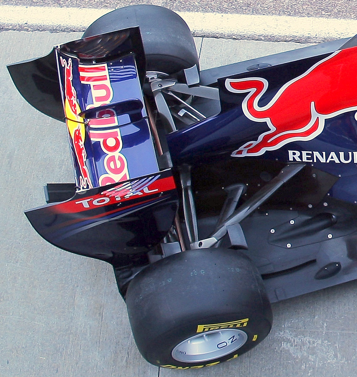

That Red Bull represents one solution, one that happened to win last year. Are you claiming it's perfect?
In another thread you yourself point out that Red Bull have fitted a wider fuel tank and elongated the gear box allowing for that shape of side pod - is their tight rear down to the pull rod or the angle of the rod itself. Would a push rod not fit on top of their gearbox in that 2011 design now that it's taller in the centre?
Just because the rear of that car looks good to your CFD capable eyeball, it doesn't mean it's the optimal solution. It may cause upstream compromises due to the packaging of the internals, such as the fuel tank, that mean a different layout and less tight rear result in a better car. What if it's more optimal for the exhausts to be closer to the centre of the car where a pull rod interferes but a push rod does not? What if the rear of the Red Bull is curved too tightly for some conditions and suffers from separation of the air flow, such that a slightly less compact rear actually performs better across the whole range of conditions?
Tim.Wright
330
Joined: 13 Feb 2009, 06:29
Re: The relative benefits of a pull rod suspension in 2011
ringo wrote:I give up!!
I'm not a religious man but. Haleujah...
ringo
240
Joined: 29 Mar 2009, 10:57
myurr wrote:That Red Bull represents one solution, one that happened to win last year. Are you claiming it's perfect?
Nope, but you still can't tell me a weakness that it has to push rod.
It would fit, but it would have to be covered with bodywork, which would interfere with the airflow, check the 2010 mercedes benz with the bumps on the gearbox.
The gearbox would automatically have to be wider as well to fit the heave springs and dampers. So basically you would have a huge lump on the car, and they would have to find openings to send cooling air.
Now, you are fishing for compromises. The redbull's tank is not short becuase of the pull rod. Mclaren and mercedes have long narrow tanks. The tank is short becuase they want it to be that way.
You see your bias? You are assuming other teams overlook pretty straight forward wind tunnel stuff, but ferrari is the only who who got it just right.
I am sure the teams have analyzed the air flow around the side pods ahead of the gearbox. RB6 had the most down force last year for a reason.
