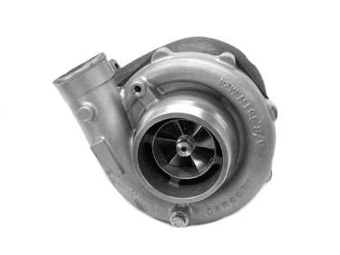

n smikle wrote:I agree with bernie.. we should keep the engines and add the turbos.
Turbos for I4 will be huge (think of something you can find under the bonnet of the trucks) and packaging would be a serious issue, the ones for the current engines would be even bigger. We may forget small sidepods and tight asses of the current F1 bolids.
As for the noise, if the turbos would be wastegated (and I bet they will) they will create enough of noise by themselves... one we can not here at the moment.
The turbo won't be that big. To make 600bhp from 1.6 liters assuming no restrictor you need something like this
What on earth are you talking about? The turbos dont need to be that big.
And almost all turbos are wastegated except for those with variable geometry. So why should that influence the noise?
I bet you are thinking of tuned street cars with open wastegates that bypasses the entire exhaust system. That ofcourse makes alot of noise but on a f1 car the exhaust system aint dampening much of the sound anyways.

godlameroso wrote:The turbo won't be that big. To make 600bhp from 1.6 liters assuming no restrictor you need something like this
That's one of the commercial TCs we are doing, rather small toy. Good enough to make the sprint from the lights.
Try to estimate mass flow, required boost, outlet temperature and pressure ratio for the 1.6 revved to >10k RPM, keep in mind you want low delta P and you will know the size of the wheels you need to put inside.
The one for R18 is far bigger than this, and the ones for F1 would be even bigger.
