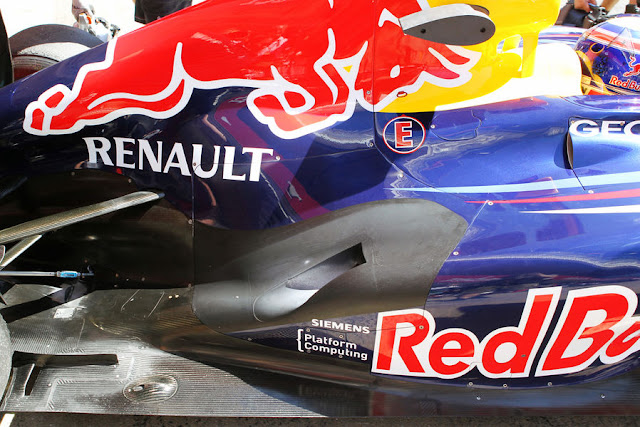

Im wondering too if the Red Bull "hole in the floor" could be adapted to the W03.
Any team in the pitlane would benefit with speeding up the airflow under the car, and this simple yet controversial development will be seen sooner rather than later on most cars IMO.
On the RB8 it redirects oncoming airflow as well as exhaust flow. How Mercedes could utilise it depends on their exhaust philosophy, but it would still work with airflow coming from the front of the car around the sidepods and back as this would still have usable energy to help speed up flow beneath the floor.
