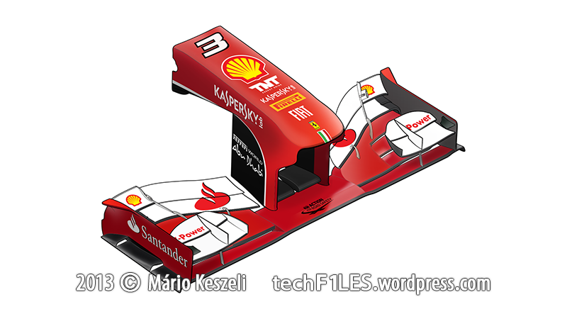

A bit late to the party, but anyway, this front wing talk needs to be pointed in the right direction. Personally, I agree with beelsebob. Different design philosophy doesn't automatically mean worse... However, I'm not an aerodynamicist, so let me quote experienced aerodynamicist from unnamed Formula 1 team.
@F1_Aero wrote:The number of elements a front wing has does not define how much downforce it creates or how 'good' or 'bad' it is. In fact, a unstalled, healthy wing with more slot gaps, will produce more loss than one with less slot gaps that is equally healthy as every slot gap causing thickening of the the overall boundary layer (this is a simplification, in practice they're unlikely to be equally healthy).
You generally only add slots once you're attempting to do more work with an element than it's capable of doing without stalling. The whole percentage stall thing is a bit of a red herring. If the last element but one stalls before the slot gap, it might end up being less efficient than a single element that stalls only towards the end of it's element.
At the end of the day, both philosophies (McLaren vs the rest of the world) have their advantages and downsides. If you read between the lines carefully, you'll come to a conclusion that the main difference is in the way aero devices downstream work the airflow outgoing from front wing's trailing edges.
Again, more elements doesn't always mean more downforce. So called 'multi-element' front wings are often misinterpreted as being more efficient in generating downforce, but in fact it's delusion. The whole point about multiple elements at the outboard edges of the front wing has more to do with flow management in yaw.
@F1_Aero wrote:If you think about what yaw does, it basically introduces a more 'difficult' onset flow condition. Teams usually develop their wing for this, and hence the number of elements will be designed for this condition, with it being 'overstable' in a straight condition. It's true that this condition may require more elements to stay healthy. The outboard of the wing/endplate tends to be the critical region so there tend to be more slots in this region.
...sorry, I know this is Macca topic ;)

techF1LES wrote:A bit late to the party, but anyway, this front wing talk needs to be pointed in the right direction. Personally, I agree with beelsebob. Different design philosophy doesn't automatically mean worse... However, I'm not an aerodynamicist, so let me quote experienced aerodynamicist from unnamed Formula 1 team.
https://pbs.twimg.com/media/BIXU1NWCIAAk9E4.png:large
TechF1LES you pretty much repeated everything I just said you do realise that. The only reason for adding more slots is to allow airflow to stay attached to the wing.
