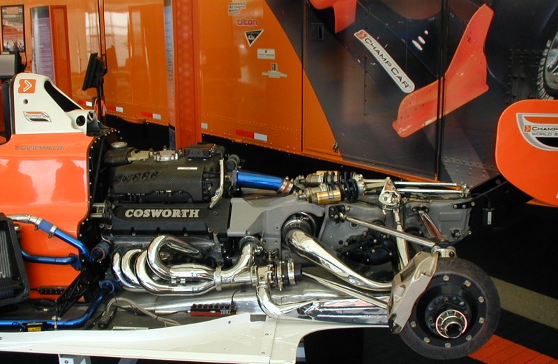

556
Re: 2014 Design
WilliamsF1 wrote:
Probably ferrari are not using an intercooler (judging by the size of the sidepod).
Placing the turbo behind the engine would require a sub frame section between the engine and gearbox which is not ideal.
http://www.kallal.ca/ccws1/tubtoe.jpg
This layout is not as bad as it seems though. Aerodynamically there is an advantage to having a longer gearbox.
