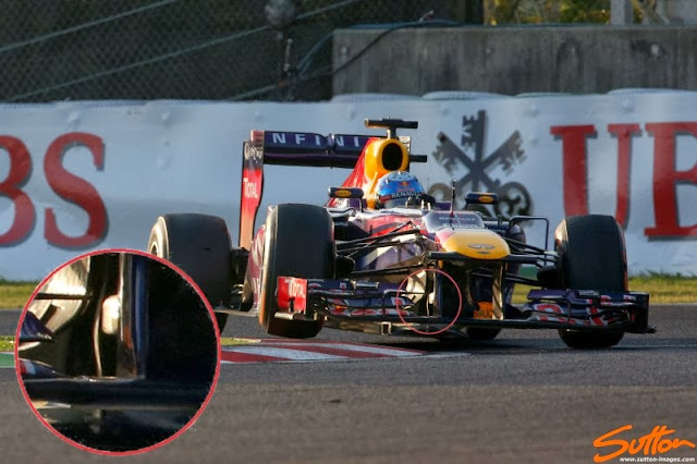

Now that is freaky..poz wrote:but the stay moves as a loose cablebhallg2k wrote:
It appears neither the splitter nor the barge boards move very much relative to the track.
Edit: some still images from the link PistoneRovente posted,
Brilliant observation, congratulations.Matt Somers wrote:The whole Splitter thing has continued to irk me even though it passed the 300 degree heat test whilst being deflection tested so I continued to dig... It's by no means conclusive and could just be flex in the stay, however when the Splitter doesn't actually impact the ground you have to look for alternatives....
Explained by Webber's higher mass perhaps?Jonnycraig wrote:Vettel has run the infrared gimmick so far this season.turbof1 wrote:That's the catch: we only know that Webber's car is running the T tray that hot. We don't know if the same actually applies for Vettel. Webber also very often chooses a different set up then Vettel does, complicating the matter further.
Perhaps Red Bull chooses Webber's car deliberately for these images. Perhaps there is something different (assumingly still legal though) going on at the t tray of Vettel, which Red Bull does not want to give away.
With regards the heat, the fact the FIA have heated it to 6 times as hot as it's getting on track and found nothing should've ended this myth.
Shouldn't be. The teams have to run camera-weight ballast on whichever camera winglets aren't being camera-mounted that weekend.FoxHound wrote:Explained by Webber's higher mass perhaps?Jonnycraig wrote:Vettel has run the infrared gimmick so far this season.turbof1 wrote:That's the catch: we only know that Webber's car is running the T tray that hot. We don't know if the same actually applies for Vettel. Webber also very often chooses a different set up then Vettel does, complicating the matter further.
