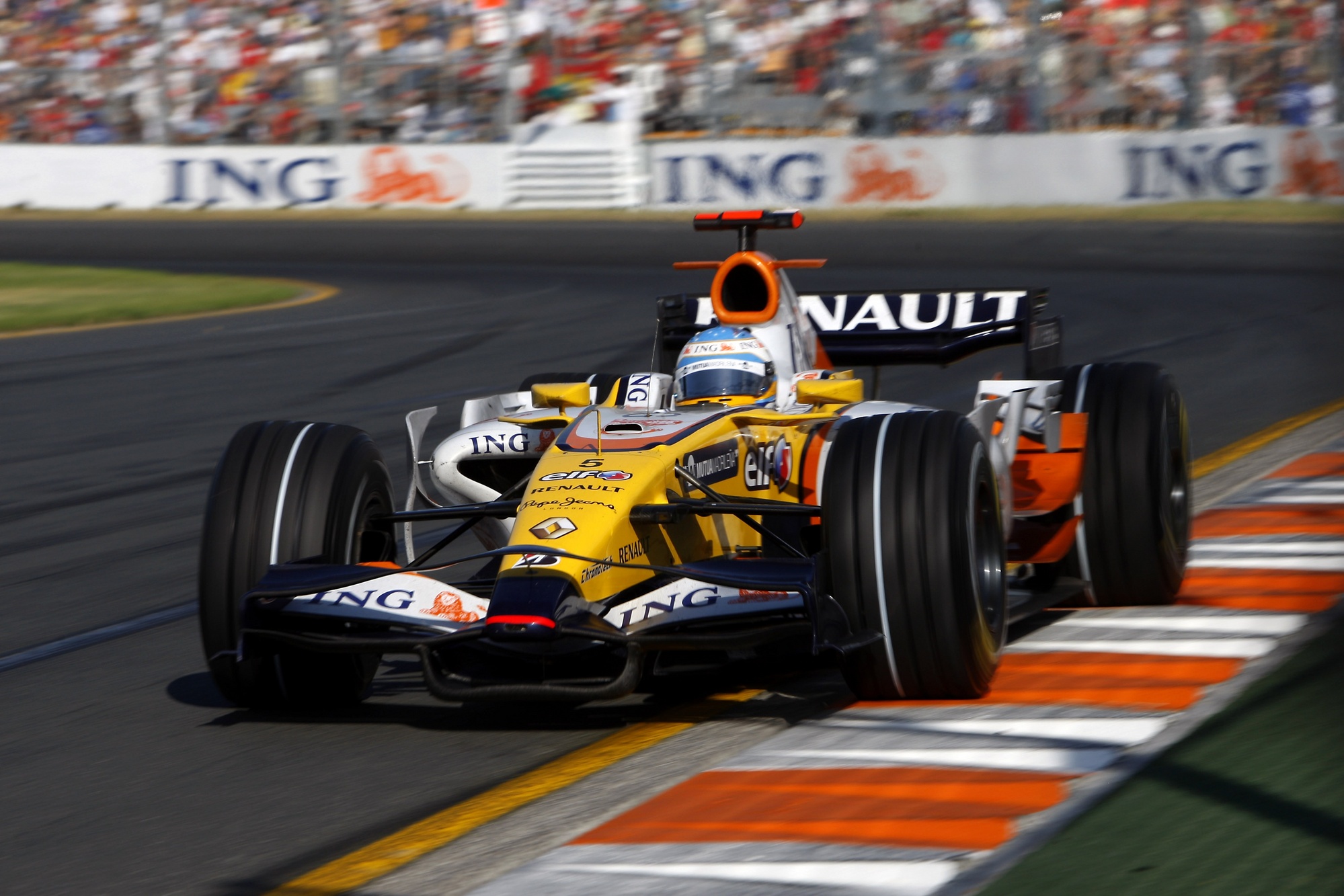

Another rear wing i liked was the Renault R28 with its cut outs next to the end plates.
Thats another one to add to the beautiful and aesthetically pleasing rear wings that Mercedes has brought us to discuss.
