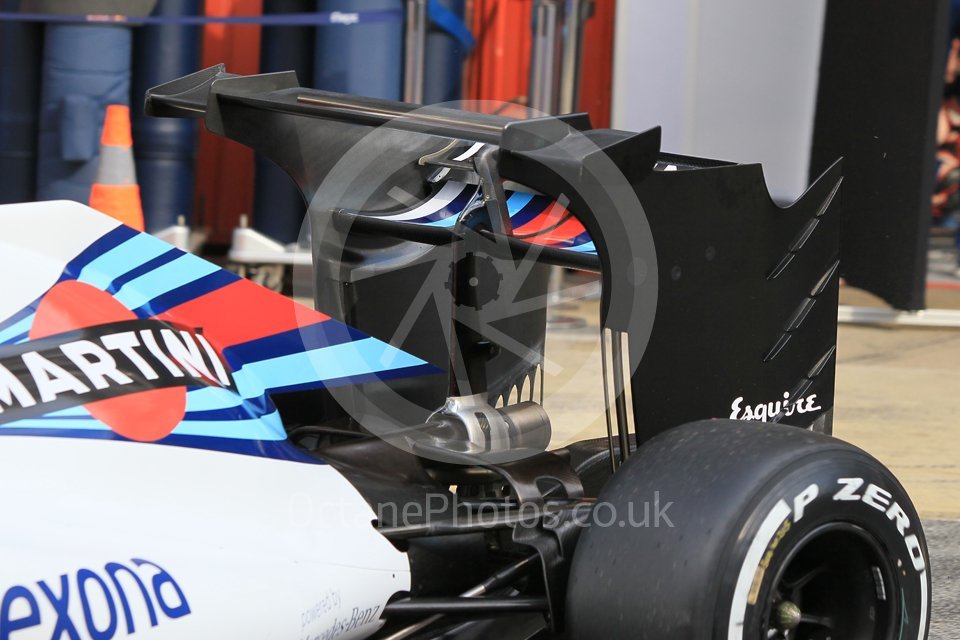

It was a common setup until it got outlawed.
People still found a way to fit this "auxiliary wing" to the small endplates for years after that when it got banned for good.

Running that extra wing, but with DRS part open is very strange.

From my perspective, they're not running 2017-level downforce; they're running 2017-level drag in a way that won't totally screw up its native configuration. In other words, I think they're doing PU work for Mercedes.
Since drag squares with speed, and the power needed to overcome it is cubed, getting engine mapping right is hugely important, especially with the convoluted nature of today's powertrains.

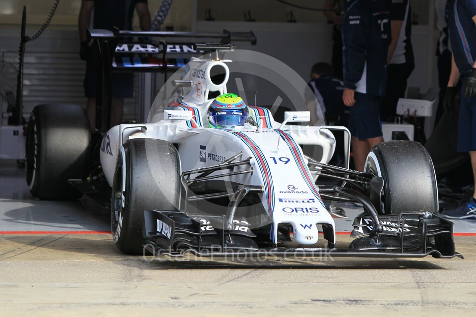

The DRS flap would be a way to fine tune the down force, right? Since the rear wing looks pretty much non adjustable.
But the DRS flap looks to be partly opened in the pictures.

Williams has historically had slow speed rear issues with the design direction of their recent cars. I would take a guess they are seeing what more rear DF does to their current chassis to see/prove that more DF is needed instead of a mechanical change.
Or maybe it is just a simulation of anticipated 2017 rear wing performance?
If it was a simple drag vs PU issue, why add such a complex wing?

The flap arrangement - the large slot gap - and the forward bias of the upper "test wing" appendage are two of the reasons why I think it's mainly a drag rig of sorts. It all looks like a way to avoid as much as possible altering the relationship between the rear wing and the diffuser. Those two components have to work together or else the whole car will get screwed up, including the front wing.
Incidentally, the front wing "stays" mounted to the camera pods are the third reason why I think it's a drag rig.
Like most teams, Williams seem to run anisotropic flaps that flex under load - mainly horizontal loading from incoming air flow - in order to reduce the wing's angle of attack and shed downforce/drag at the end of straights...
The camera pod stays seem likely to prevent that sort of flex in a way that wouldn't alter existing aero maps...

I think that they are just experimenting with aero balace. They can use DRS to adjust rear downforce on the run without entering the pits. So my guess is, that, those things connecting the front wing and camera pods would change the angle of the wing to adjust front downforce without entering the pits as well. They can go throu many more configurations with this system. The front wing can probably generate more downforce on its own, where they needed the extra wing for the back if they wanted optimal balance at the back with front wing configuration for max front end downforce.
I hope you guys know what I wanted to say [-o<

Very interesting ideea! So they have an active (semi-active) aero balance system :)

That would be my guess yes, the extra wing is there so that they have more room to play with.
