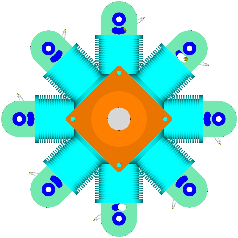

A 2,000cc Cross-Radial aircooled heavily turbocharged direct injection Diesel PatAT engine:
(animation at http://www.pattakon.com/PatAT/PatAT_Cross_Radial_1.gif )
can provide easily and reliably some 50% more power than the V-4 of Marin JetPack (the 2,000cc 4-in-line BMW turbocharged di Diesels provide some 200PS, and they are 4-stroke engines) with less than half specific fuel consumption, with nearly half weight, with true free-of-vibrations operation, with low specific-lube-consumption etc, etc.
Think also about the manufacturing cost of the PatAT Cross-Radial.

a single-row 2-stoke PatAT Cross-Radial turbocharged Diesel is another approach having its own characteristics / advantages for aviation applications:
However, like the PatRoVa it is unconventional and needs to be put to the tests.
