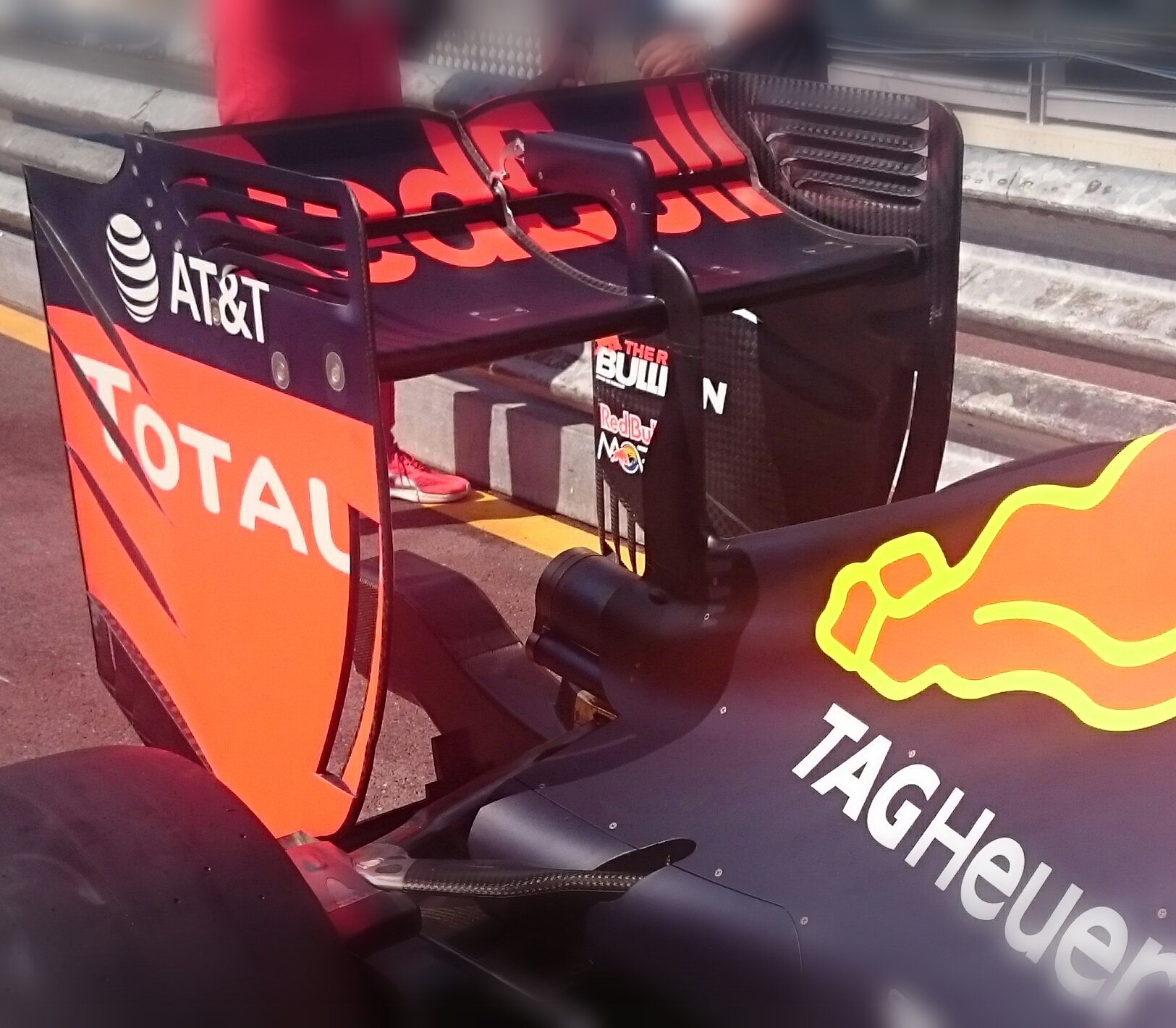

And without a monkeyseat !? in Monacco!

lio007 wrote:And without a monkeyseat !? in Monacco!
https://pbs.twimg.com/media/CjUDzA2XIAA7nwi.jpg:large
Its most likely a package that simply sees no benefit from a monkey seat. Maybe the flows in that will see a monkey seat mostly just adding drag.
I think it's an aero balance driven decision. Since good steer-in is required in Monaco, it makes no sense to introduce addition rear downforce and thereby move the CoP backwards. According to the article here on F1t, this is something Williams is experimenting with as well (Barcelona test).
