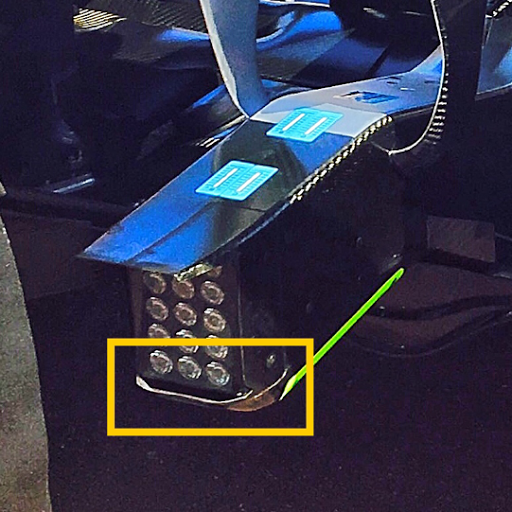

The FIA has mandated that the bottom of the crash structures can't use a small metal section that the rear jack sits on. Apparently in that recent Billy Monger crash that metal section split the crash structure causing the damage to be greater.
