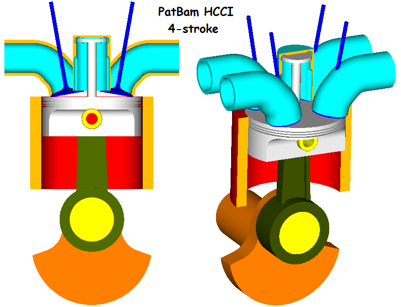

Hello all.
Regarding the PatBam HCCI (for 2-stroke and 4-stroke engines), the following are added yesterday in the http://www.pattakon.com/pattakonPatBam.htm :
In the following GIF animation it is shown the (calculated) pressure and temperature (adiabatic compression and expansion) in the main chamber and in the auxiliaty chamber of a PatBam:
The compression in the auxiliary chamber is as high as required to auto-ignite the fuel used; when the two chambers unite, through the transfer ports, the burnt gas streaming into the main chamber:
1. increases the pressure (shock wave),
2. increases the temperature (heat wave),
3. and injects the radicals into the main chamber.
Thanks

The PatBam HCCI is different.
In the following PatBam HCCI design:
the diameter of the auxiliary piston is about 1/3 of the diameter of the main piston.
Similarly, in the following 4-stroke PatBam HCCI:
and from the "piston side", in case a Ducati Panigale is modified to PatBam:
This means that the surface of the auxiliary piston is about 3^2 times smaller than the surface of the main piston.
No matter how high the compression ratio in the auxiliary chamber is (say, it is 20:1 to cause the auto-ignition of the air fuel mixture at all conditions), the resulting loads on the kinematic mechanism are not heavy.
By the way: the HCCI combustion is not really instantaneous. It is some 5 – 6 times faster than the progressive burn in the Spark Ignition engines, but not instantaneous.
Keeping low the compression ratio in the main chamber (say, 11:1), the near “constant volume combustion” triggered by the entering from the auxiliary chamber burnt gas, cannot cause excessive loads on the kinematic mechanism.
As the Diesels, similarly the HCCI engines run better on lean mixtures; the leaner the better.
In the road tests of the Mazda SkyActivX (an almost HCCI engine) the consumption gets better if the engine runs at higher revs and lighter loads (instead of the conventional: lower revs, heavier loads).
It is not possible to consume all the oxygen in the cylinder of a Diesel engine. This is the way it works: from lean to extremely lean (at idling).
Yet the Diesels with the lean burn achieve higher BTE than the Spark Ignition engines.
And because the Diesels and the HCCI engines fit better with turbo-charging and super-charging, they are able to make lots of power.
So, the PatBam separates the HCCI combustion in two chambers, achieving a simple, yet strong control.
The high pressures in the auxiliary chamber cannot create extreme loads.
Neither the near “constant volume combustion” in the main chamber, which runs at low compression ratio, can create extreme loads on the kinematic mechanism.
With a 11:1 compression ratio in the main chamber, a BTE similar to that of a Diesel having 16:1 compression ratio (and running in near “constant pressure combustion) is reasonable.
As for the fuel, a low octane cheap gasoline is the best fuel for the PatBam.
The basic problem of the Diesel engines is their emissions (NOx and particulates).
The direct injection gasoline engines have similar problems with the Diesels.
The HCCI is a solution. But the HCCI needs strict control And the PatBam offer such strict control over the HCCI combustion.
Thanks
Manolis Pattakos

I looked at similar arrangements a while back. My conclusions were:
The greater surface to volume of the ante-chamber would (unpredictably) influence the point of ignition.
That the pre-TDC forces on even the smaller area of the piston protrusion would still be unwelcome.
That when applied to a 2T the homogeneous incoming charge would lead to fuel loss to the exhaust port and high UBHC (the usual 2T curse).
That any carbonisation in the small communicating ports of the ante-chamber would in service deteriorate the process.
That maintaining correct clearances at all temps was going to be problematic.
That maintaining geometrical integrity of the protruding piston after prolonged service was likely to be problematic.
That ultimately due to having to run (for reasons of lack of bottom end strength) lean mixtures no reasonable specific power output is achievable.
Some time prior, I also looked at divided chamber / torch ignition systems (which your (Manolis) PatBam is a a variation of). My conclusion was:
That there will always be throttling losses which degrade efficiency. That conclusion was reached at the same time as the launch of common rail injection systems which capitalised on dispensing with ante-chambers and deploying direct injection - with an immediate increase in thermal efficiency as a consequence. It never occurred to me (and probably never would) to reduce the ante-chamber volume to the levels so done with the TJI system. Not least because the prospect of employing an additional fuel injector to release such a very small volume of fuel isn't something the OEMs are going to be thrilled by.
At least one OEM that has investigated HCCI has concluded that their objectives can be met by using simpler and more familiar technology. The current market place (lack of saleable HCCI) endorses that view.
HCCI is infinitely better suited to free-piston designs such as those using the engine core as a gas generator to provide gas for a turbine (where the lean mixture is no handicap and nearly an asset) but the very low pressure ratios across the turbine(s) condemn such a configuration to poor thermal efficiency.
I really cannot envisage any bright future for HCCI - unless it is true that Honda are using it in F1 and it (Honda) make some breakthrough to curb all HCCIs negative aspects.

Hello Pinger.
You write:
“The greater surface to volume of the ante-chamber would (unpredictably) influence the point of ignition.
That the pre-TDC forces on even the smaller area of the piston protrusion would still be unwelcome.”
The PatBam architecture is tolerant to the “point of auto-ignition” in the auxiliary chamber.
Suppose the ignition happens 5 degrees earlier. The differential of the torque applied to the crankshaft is small because the auxiliary piston area is small and because the auxiliary piston is near its TDC wherein the eccentricity (from the rotation axis of the crankshaft) of the force applied to the crankpin by the connecting rod is small.
After its “spontaneous combustion” the burnt gas into the auxiliary chamber is further compressed (and heated) until the “transfer ports” open (which happens at a constant crankshaft angle, say 10 degrees before the TDC) allowing it to burst into the main chamber.
I.e. the “unpredictable” timing of the auto-ignition in the auxiliary chamber is not affecting the combustion into the main chamber.

In the OPRE Tilting opposed piston HCCI (animations in previous post), the two pistons are symmetrical and serve, both, the intake and the exhaust. Their motion is symmetrical. They slide inside the same cylinder that keeps them “coaxial”. These all allow the minimization of the clearances (for the moment it is not clear what the optimum clearances are; hopefully we will know soon).
You also write:
“Some time prior, I also looked at divided chamber / torch ignition systems (which your (Manolis) PatBam is a a variation of)”
Any images? Any photos? Any patent numbers?
You also write:
“It never occurred to me (and probably never would) to reduce the ante-chamber volume to the levels so done with the TJI system. “
The size of the auxiliary chamber depends on the fuel and on the operational conditions. If the main chamber is kept just below the threshold for auto-ignition and the auxiliary chamber is kept slightly above the threshold for auto-ignition, the auxiliary chamber capacity can be as small as in the TJI without the complication / cost associated with the TJI and with way better penetration of the burnt gas into the compressed air-fuel mixture in the main chamber.
The basic objective is to confine the high pressures necessary for the auto-ignition inside a small chamber and then to use it for the ignition of the charge in the big chamber which is intolerant to extreme pressures, to extreme pressure differentials and to extreme pressure “jerks”.

In comparison the PatBam provides strict control over the HCCI combustion, being by far simpler.
Here is an animation of a PatBam Cross-Radial PatAT :
Four-stroke-like lubrication, external scavenge pump, asymmetric transfer, full balance, no need for high voltage system, it runs better on cheap low octane gasoline, etc, etc.
It’s architecture makes it so lightweight that even when it runs extra lean (say, AFR=2) it still can provide top specific power.
