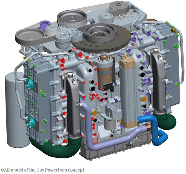

Quote from https://newatlas.com/cox-diesel-powertain/26032/
“The Cox Powertrain concept is being developed in collaboration with the engineering R&D firm Ricardo. The project has already attracted £6.7 million (US$10.1 million) in private investment, in addition to previous MoD funding. The concept is based on an invention of Cox Powertain’s founder, former F1 designer David Cox, and is specifically designed for outboard use.
The concept uses opposed pistons, which means that the super-charged. two-stroke 3.6-liter motor has eight pistons housed in four cylinders. There’s no cylinder head, but rather each cylinder uses a centrally-placed injector, and the piston pair compresses the fuel/air mixture in the middle. Meanwhile, a Scotch Yoke crankshaft converts the reciprocating movement of the pistons into rotary motion.
End of Quote

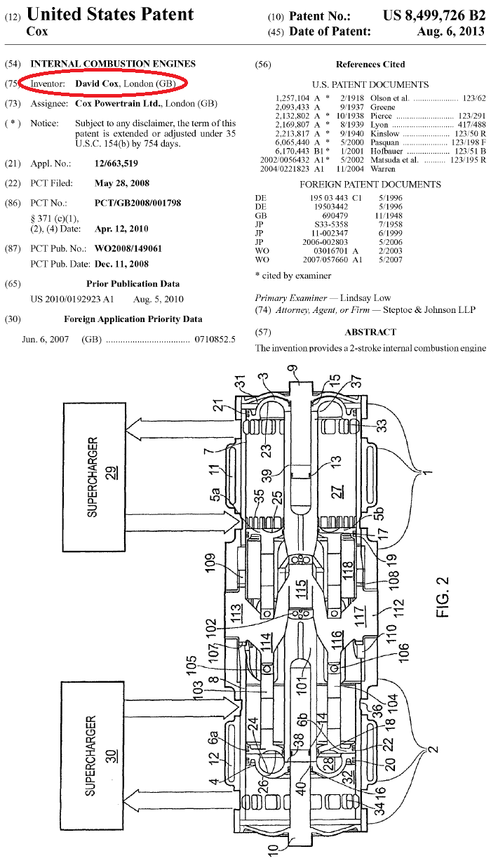

Here is the US Patent of David Cox :
Here is an animation made with the drawings of Cox’s US Patent:
It is an Opposed-Piston Opposed-Cylinder engine (say, like the OPOC of the EcoMotors).
The cylinder liner seems as being of the “sleeve” type (it performs a short reciprocation).
The scavenge pump capacity is half than the combustion chamber capacity. Reasonably they use external turbo and/or super charger.
The big diameter pillar / pile / column / post, is not the best thing to put in the center of the combustion chamber.
But the big issue is the Scotch Yokes.
Here is the Scotch-Yoke of CMC:
which is not for an Opposed Piston engine.
In the COX engine, each combustion chamber is served by two Scotch Yokes (t
he one “double” at the sides of the central one), with each Scotch-Yoke receiving the full load from the combustion pressure.
It is supposed that the thrust loads between the cylinder liner and the piston skirt is a main cause of mechanical friction in a reciprocating piston engine.
And, depending on the con-rod to stroke ratio, these thrust loads are several times smaller than the full pressure load on the piston top.
The big question is how much of the mechanical energy is burnt in the Scotch Yoke mechanisms at the various operational conditions.

Just had a very quick look over the Cox engine and this seems to me to be a viable direction for a 2T auto engine.
Limited supercharge (short charging time) should contain NOx, and the absence of poppet valves (which on a 2T running at any reasonable speed require massive acceleration rates).
Your comment.....
manolis wrote:
09 Jan 2018, 09:50
..... kind of reinforces something I have been saying for some time. That is, the reticence of OEM to accept unfamiliar architecture. You too appear to have your doubts.

“Just had a very quick look over the Cox engine and this seems to me to be a viable direction for a 2T auto engine.”
Why the Scotch-Yoke Cox design seems to you a “viable direction” for a 2-stroke auto engine?
Which are its key advantages?
And why a conventional Scotch Yoke design (like that of CMC that manufactured a number of 4-stroke Boxer engines spending a few million dollars before bankrupting) is not good for a 4-stroke auto engine?

To reduce the friction of the Scotch Yoke, Bourke replaced the flat / plain bearing with a track roller bearing:
Bourke failed due to the resulting extreme local loads (linear contact).

manolis wrote:
09 Jan 2018, 18:55
Why “the porting wont permit it”?
If you look at the Cox engine GIF animation, the exhaust ports open first and close first.
The charger (turbocharger or supercharger) pushes air into the cylinder even after the closing of the exhaust ports.
But that period is very brief.

manolis wrote:
09 Jan 2018, 18:55
But even without asymmetrical timing of the ports, a turbocharger can overcharge the cylinder.
Say, by keeping the exhaust and the intake at higher than ambient pressures.
Until the pistons melt.....

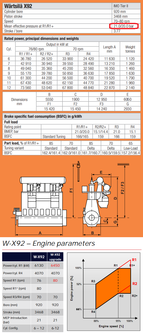

Don’t believe me. Believe Wartsila:
Their giant low-speed X92 marine 2-stroke is turbocharged (there is no conventional scavenge pump) and runs continuously at 21bar Mean Effective Pressure.
Let’s make a calculation / confirmation with the data provided in the above table.
With 21bar (21Kp/cm2 = 210N/cm2) acting on the 920m (92cm) diameter piston for a distance of 3,468mm (3.468m), the energy produced is:
(92^2*pi/4)*210N*3,468m=4,841,321Joule.
And with 76rpm the power per cylinder is: (76/60)*4,841,321 J/sec = 6132kW
See the power per cylinder at the table at the bottom left. It is 6,130kW
Is the 21 bar BMEP low or high?
It is very high.
To get an idea, the high tech naturally aspirating 4-strokes (of cars, motorcycles etc) run at ~12bar BMEP (which means a specific torque of ~100mN per liter of displacement).
By the way, the typical medium speed heavily turbocharged 4-stroke marine Diesel runs at lower than 25bar BMEP (which means the 2-stroke delivers 2*21/25=70% higher power per liter of capacity).
Worth to mention:
The BMEP in a 2-stroke “acts” per crankshaft rotation, while the BMEP in a 4-stroke “acts” per second crankshaft rotation.
For the same BMEP and the same capacity, the 2-stroke makes double power.
I hope it is clear now that a 2-stroke can be turbocharged and supercharged heavily, at a degree similar to that of the 4-strokes.
