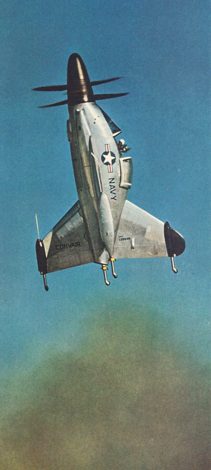

Hello all.
“Aerodynamic Control” versus “Weight Displacement Control”
The GEN-H4 has only “weight displacement control”: the pilot by pulling / pushing a lever, displaces the center of gravity of the GEN-H4 relative to the rotation axis of the contra-rotating rotors (i.e. relative to the thrust force).
The Corvair POGO-XFY-1:
which weighs 5 tons (11,000lb),
has only aerodynamic control (the flaps/ailerons at its lower/back end), just like this “two-seater” Flyer:
The pilot of the Portable Flyer
has both controls:
Being always (from take off to landing) inside the downwash of the propellers, he has “full aerodynamic control” like the POGO (using his hands, feet and head as flaps / ailerons),
While by displacing his head / limbs relative to the engines he has also the “weight displacement control” of the GEN-H4 (and of Zapata / Mayman / Browing Jetpacks)
PS: Yves Rossy (BirdMan) has aerodynamic control, but ONLY after reaching a high speed. Enjoy his flight over Dubai:
Thanks
Manolis Pattakos
My last post on this topic. Manolis, the Pogo control surfaces were huge and rigidly attached to the airframe, which was rigidly attached to the engine and propellers. When control inputs were made the aircraft acted as a single rigid unit and torques were generated to control the machine. Your hands and feet controls, flying freely in the airstream while hanging from the motor unit, will not generate controlling forces and, as they are not in any way aerodynamic, will provide random control inputs meaning the pilot will have no ability to finely (if at all) control this machine. Do some calculations re stability as I suggested earlier. If you can show some positive stability then great. I think this machine might go up and down vertically, but you have no controls capable, except in pictures, of guiding this thing, let alone rolling to sustained horizontal flight. Even the Pogo pilots found their machine very difficult to fly; the personal flyer looks like a death machine destined to spiral out of control into the ground with no way to release a parachute. Here's an idea, incorporate some sort of emergency release that will jettison the motor unit in an emergency, allowing the deployment of a parachute. Of course, the freed propeller unit may just generate the chop you are trying to avoid....
I like your motor, but I think the rest needs a lot of work and perhaps you need to learn to take input and not simply reject all suggestions with a verbal explanation. Numbers count and analysis and consideration of the actual aerodynamics would be, in my opinion, a useful exercise. I am not a novice in this area and I see serious problems and a lot of denial, which is not a river in Egypt. If you have some analyses of the aerodynamic forces it would be interesting to see them.
