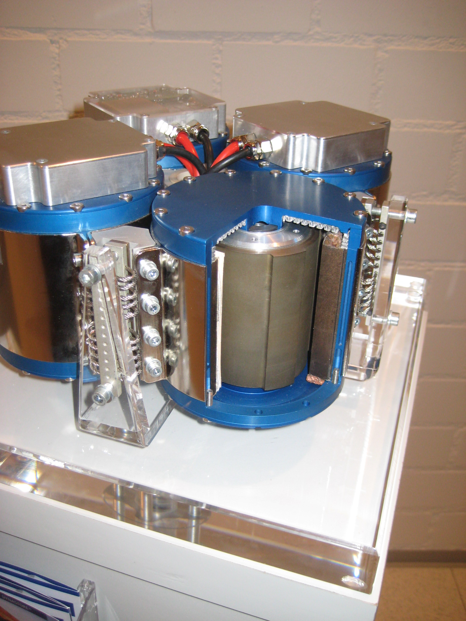

I have to share some ... let's call them rumors from a German Board regarding BMW's KERS. It is said, that they cooperate with a company called Compact Dynamics - located next to Munich. They developed a flywheel storage, some technical data (although a German document) can be found here. And here is a real-world picture of the solution. As you can see, it's based of four flywheels which is rumored to be better than a single flywheel in terms of packaging but not in terms of efficiency. Some other rumors from a source I personally trust:
- It's watercooled
- Almost vacuum conditions inside the flywheel package - which is logical IMHO
- very high RPM count - is kind of a non-info. All flywheel storages have very high RPM counts - but maybe he means very high relative to other solutions. So it could possibly be as much as or even more than 200.000RPM.

BorisTheBlade wrote:They developed a flywheel storage, some technical data (although a German document)
I found some technical info in english...here's the link:
http://www.eki-gmbh.com/innovationen/KE ... 080819.pdf
According to this document, overall efficiency (charge+boost) is 65%.

Flybrid also claims efficiency of 65% for their flywheel KERS solution. They also claim weight of 25kg, and that would be 10kg lighter system when compared with Compact Dynamics.
