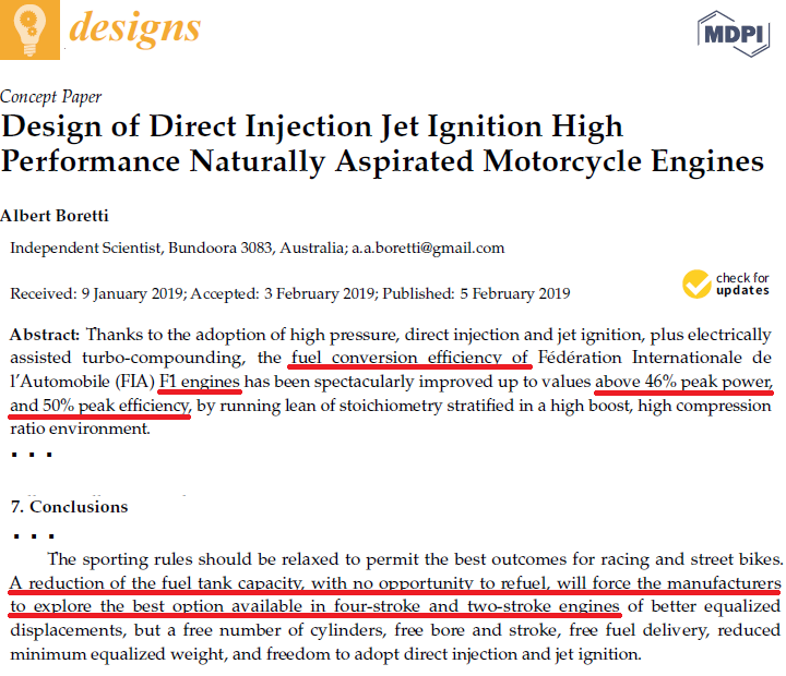

Boretti’s “Concept paper” begins with the measured fuel efficiency in the F1 engines:
46% at peak power and
50% at peak efficiency
and ends up with a wise suggestion:
“Reduction of the fuel tank capacity with no opportunity to refuel”.
The above suggestion is like saying:
“Cancel the numerous limitations you have now and leave free the Moto-GP (and Formula 1) teams to focus on making powerful fuel efficient engines”,

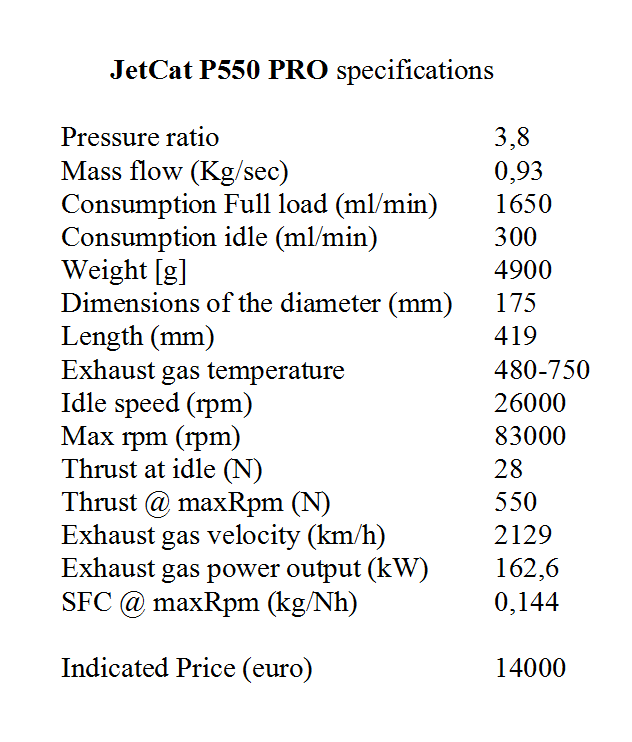

Based on the above specifications, let's make a few calculations:
The idling consumption of the four JetCat P550 of Yves Rossy’s DeltaWing is: 4*300ml/min = 1.2lit/min = 72lit/hour.
The full load consumption is 4*1650ml/min = 6.6lt/min = 396lit/hour
The maximum thrust force is 4*550N = 2200N = 220Kp = 480lb
With, say, 30 liters of fuel in his DeltaWing, Rossy can fly at full power for 30lt/6.6lit/min = 4.5 minutes.
With the same 30 liters fuel the four JetCat P550 turbines of Rossy can idle for 30lit / 1.2lit/min = 25 minutes.
The weight of the four turbines is 4*4900g = 196N = 19.6Kp = 43lb; in this weight it is added the DeltaWing weight, the fuel weight and the pilot weight.
With the 480 to 750 degrees Celsius exhaust gas temperature the pilot has to keep his limbs away from the exhaust gas.
The supersonic speed of the exhaust gas (2,129Km/h, Mach 1.7) causes extreme / unaffordable noise.
The cost of four JetCat-P550 turbines is over 50,000 euro; in this amount has to be added the cost of the rest DeltaWing “aircraft”.
Thanks
Manolis Pattakos

The “JetMan-Dubai” team claims 400Km/h top speed for “their” Rossy’s DeltaWing.
Based on the JetCat P550 specifications, let’s see what the various numbers have to “say” and how they connect with each other:
With 400Km/h (111m/sec) speed and 2,200N total thrust, the power that pushes the DeltaWing forwards is:
P = 111m/sec * 2,200N = 245kW
The energy E provided per hour by this power is: E = 245kWh.
Supposing a specific gravity of 0.8Kg/lit for the fuel,
the 4*1650ml/min = 396lit/h fuel consumption per hour of the four jet turbines at full load gives a “BSFC” (Brake Specific Fuel Consumption), if we can call it so, of:
396lit * 0.8Kg/lit / E = 316Kg / 245kWh = 1280gr/kWh
and the resulting “BTE” (Brake Thermal Efficiency), if we can call it so, is:
80g/kWh / 1280gr/kWh = 6%
Where the 80g/kWh comes from?
80gr/kWh is the BSFC of an ideal engine running at 100% BTE;
When a giant marine low-speed 2-stroke Diesel engine consumes 160gr of fuel per kWh of mechanical energy produced, it operates at 80/160 = 0.5 = 50% BTE.
The total Exhaust Gas Power Output is 4 * 162.6kW = 650kW, while the power that actually pushes the pilot / DeltaWing is, as previously calculated, P = 245kW.
That is, the four jet turbines provide 650kW + 245kW = 895kW of power from which the 27% ( 245 / 895 = 0.27, i.e. about one quarter) pushes the pilot / aircraft forwards, while the rest 73% (nearly the three quarters) is lost in the exhaust gas.
This means that the jet turbines run at 22.5% BTE ( 80gr/kWh / (316Kg/h / 895kWh)= 0.225).
22.5% = 6% + 16.5%
The 6% of the fuel energy pushes the aircraft forwards,
the 16.5% of the fuel energy is lost with the high speed exhaust gas,
while the rest 77.5% of the fuel energy is never transformed into “mechanical” (or “aerodynamic” etc) energy.
In the JetCat P550 specifications the Exhaust Gas Power Output is given as 162.6kW;
Taking the derivatives of both sides of the kinetic energy equation:
E = (1/2)*m*v^2
it results:
dE/dt = (1/2) * dm/dt * v^2.
(the dm/dt is the mass flow; the speed v of the exhaust gas is constant 2129Km/h).
(1/2) * (Mass Flow) * (Exhaust Gas Velocity)^2 = 0.5 *0.93Kg/sec * (2129Km/h)^2 = 0.5 * 0.93Kg/sec * (591.4m/sec)^2 = 162.6kW, which is the Exhaust Gas Power Output given in the specifications.
In the P550 specifications the Specific Fuel Consumption (Kg/Nh) is given as 0.144;
0.144Kg/Nh = 1650ml/min * 60min/h * 0.008Kg/ml / 550N
(0.008Kg/ml is the fuel specific density, 1650ml/min is the fuel consumption at full load).
For the pilot, who is “in the open air”, the 400Km/h speed seems exhausting, if not unaffordable for more than a few seconds.
At lower speeds, say at 200Km/h, a substantially smaller portion of the power provided by the turbines is utilized to propel the aircraft, while the rest power provided by the turbines is lost with the exhaust gas; however the aerodynamic resistance falls more (it falls with speed square).
The lower the speed, the smaller the portion of the power provided by the turbines that is actually used to propel the aircraft, with the rest power being lost in the exhaust gas (in case of zero speed, while the turbines continue to consume fuel, all the energy they provide goes to the exhaust gas).
The higher the speed, the more of the turbine power goes to propel the aircraft, and the less power is lost in the exhaust gas.
Quiz:
Suppose Rossy wants to cross Calais channel (some 22miles / 35Km) with his new DeltaWing.
At which speed the required fuel is minimized?
According the previous,
at normal / affordable speeds, say from 100 to 150mph (160 to 240Km/h), only 3%, or so, of the fuel energy is propelling the Jet-Pack Flying Device; the rest fuel is burnt to accelerate the exhaust gas and to warm the atmosphere.
Even if the CO2 footprint was not an issue, the running cost gets extreme.
Worse even, the weight of the required fuel for a useful (say, 50Km) range becomes too high, and this weight has to be lifted by the JetPack Flying Device (just like heavy batteries have to be lifted by the electric Flying Devices).
In comparison, the Portable Flyer with its internal combustion engines and its propellers is many times more efficient than the JetPacks, it needs many times less fuel for the same range, it has many times longer range with the same quantity of fuel, it has many times smaller CO2 footpinrt, it has many times lower running and ownership cost, etc.
Thanks
Manolis Pattakos

The best thing with the physical laws is that they are correct at all cases, without exceptions and limitations.
So, be more specific explaining where the formula F*v=P was incorrectly used / applied.
You also write:
“Rossi and his colleagues gain speed when they go into a dive, right? So does this mean, the efficiency of these engines depends on the attitude they are in? Get they more efficient when they face to the ground?...yes, it's a rhetorical question…”
People who dive freely (unpowered) can reach speeds well above 400Km/h.
At 3:35 of the video is given the world record as 531Km/h
Quote from Wikipedia:
  • “Speed skydiving is a skydiving competition in which the goal is to achieve and maintain the highest possible terminal velocity. It was developed in the mid 2000s and is the fastest non-motorized sport on Earth. The speed, achieved by the human body in free fall, is a function of several factors; including the body's mass, orientation, and skin area and texture. In stable, belly-to-earth position, terminal velocity is about 200 km/h (120 mph).
    Stable freefall head down position has a terminal speed of 240–290 km/h (around 150–180 mph). Further minimization of drag by streamlining the body allows for speeds in the vicinity of 500 km/h (310 mph).”
End of Quote.
Rossy’s ex-team in Dubai claim they can fly (fly horizontally, not dive) at speeds of up 400Km/h.
Quote from https://newatlas.com/aircraft/jetman-vt ... on-winged/
  • “The winged flight capability sets the Jetman team apart from other jet-powered personal flight devices like jet boards, jetpacks and jet suits, because it allows more efficient flight at very high speeds of up to 400 km/h (250 mph), as well as some pretty awesome aerobatic capabilities.”
End of quote
You also write:
“Rossi never claimed it would be the future of personel transport. Rossis Wing is just a fun toy mainly for himself and he build it to be exactly that. It's like F1 cars in that regard. They aren't meant for the average person.”
I bet Yves Rossy does not agree with you.
But Rossy’s Delta Wing is powered by jet turbines which put several limitations like short range, low mileage, extreme noise, extreme ownership and running cost, etc, etc. These limitations are what makes his Delta Wing an expensive toy, not a useful transportation means for everyone.
Replace the jet turbines of Rossy’s DeltaWing by piston engines driving propellers and you have a small VTOL airplane (say, a scaled down OSPREY V22) which may be the future of personal transportation.
Thanks
Manolis Pattakos
