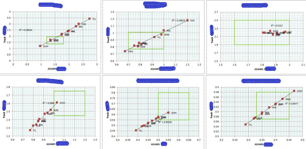

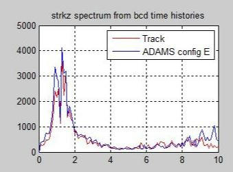

I model primary ride and secondary up to 10 Hz in ADAMS. I can't tell you much as it is bleeding edge work, and the way measurements are processed are proprietary. I got it to work about 4 years back. We have full 2d models of the wheeltracks at 5 mm or so resolution in X. We can use it to get a first pass tune for the shocks springs and sta bars.Here's a comparison between track and ADAMS for seat track Z. Seats are crucial but are handled separately

I have a similar level of correlation at my end. I would like to know, how do you bring a numerical value to the level of correlation. i.e, having 50% correlation or 75% correlation and so on.

Ah, well that's where your abstracted metrics come in. You might decide that bounce is best represented as (say) RMS seat track Z vibration 0.5-4 Hz on a particular road at a particular speed. Then you can compare your model and the vehicle. That's a made-up example and would not work, as it confuses pitch and bounce. Sadly I can't tell you what our metrics are for ride, we use 6, of which Bounce is obviously one. We tested several levels of shock absorber tune on the road and then I modelled them and we got good results for 5 of the 6, but hopeless for the other one.

Yeah I guess that makes more sense. Basically, you restrict the frequency band between 0.5 to 4Hz and then a basic comparison of the amplitudes put a numerical value to the difference.
