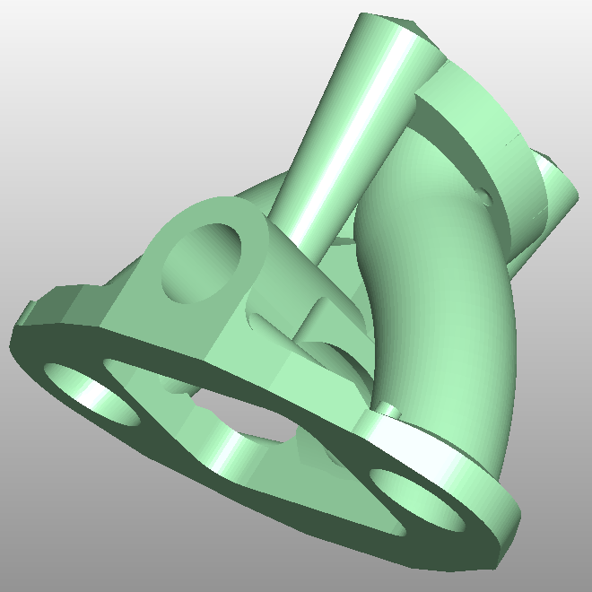

From what I know, a 3D-printer is the most cost-efficient tool (device) for prototyping (provided its owner / user can design in some CAD).
With US250$, or so, you take what you need in order to make any plastic pattern you like; lots of them (the material consumed – PLA or ABS – costs some US20$ per Kg (if the part is not solid but it is made as a thin empty shell, the material consumed is several times less).
The measured accuracy of the 3D-printed pattern is surprisingly high.
And if you have time to spent, the “try and error” learning procedure can be applied as many times as you like, without cost.
Yes, the 3D-printers are slow.
However you can leave the printer alone to work all night long (it is quiet enough), and the next day you have the pattern.
When you finish with the “plastic” prototyping, you can either proceed to CNC machining of the part “from billet” (this costs a lot and is not always possible), or you can cast the part (say by the “lost wax” method) and then finish the part in a CNC machine shop.
With a plastic model in your hands, the machine shop owner understands in seconds what you want, and if (he can machine it) his offer is closer to reality.

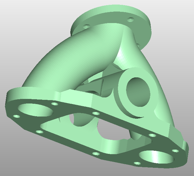

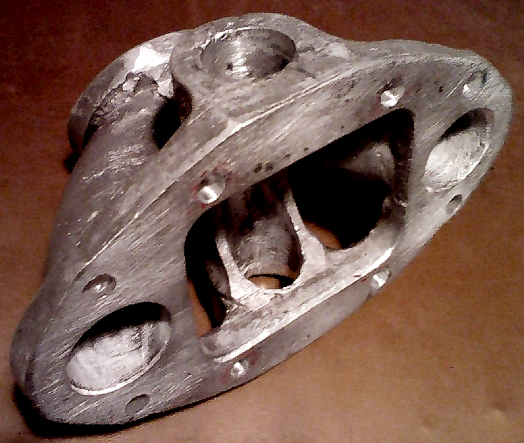

Case study:
Here is the Broom OPRE Tilting:
The inlet manifold could also support the (yellow) shaft whereon the propellers (not shown) are rotatably mounted, like:
Here is the part (as STL file) sent to the 3D-printer (it comprises the lower side of the “sprues”):
