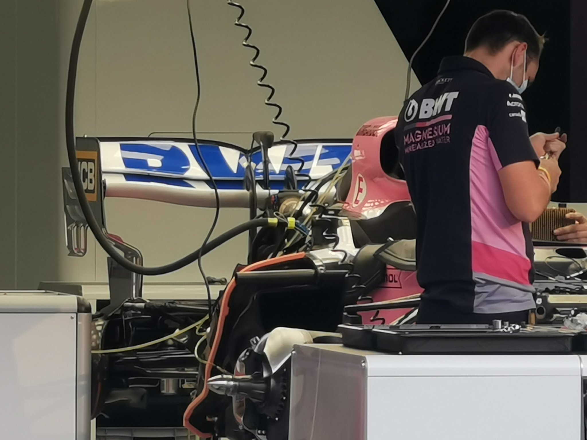

Re: Racing Point RP20
Sakhir GP
Via Motorsport.com
Morteza wrote:
03 Dec 2020, 17:11
Sakhir GP
https://pbs.twimg.com/media/EoUk-llWMAE ... name=large
Via @AlbertFabrega
That's a bit bigger than I'd expect from a track that has somewhat Monza like character. Maybe the rough asphalt and the slow corners mean they selected that as the optimum set up to start from?
Small point. But I thought it was interesting that in this picture you can see the diffuser footplate near the wheel closest to the camera doesn't have the smooth surface like the other side. Maybe they use a cover for it? Hard to make out.
204
Joined: 23 Feb 2008, 17:55
That's called perspective. The details you refer to aren't visible on the other side because they are covered by the diffuser
Few other perspectives show the same thing.
Owen.C93 wrote:
11 Dec 2020, 18:14
There have been 2 pictures posted here, both from the same side. Apart from any possible differences being blocked from view, it's also illogical to assume that such a dedicated aerodynamic element, that has quite an important use, would be asymmetrical.
