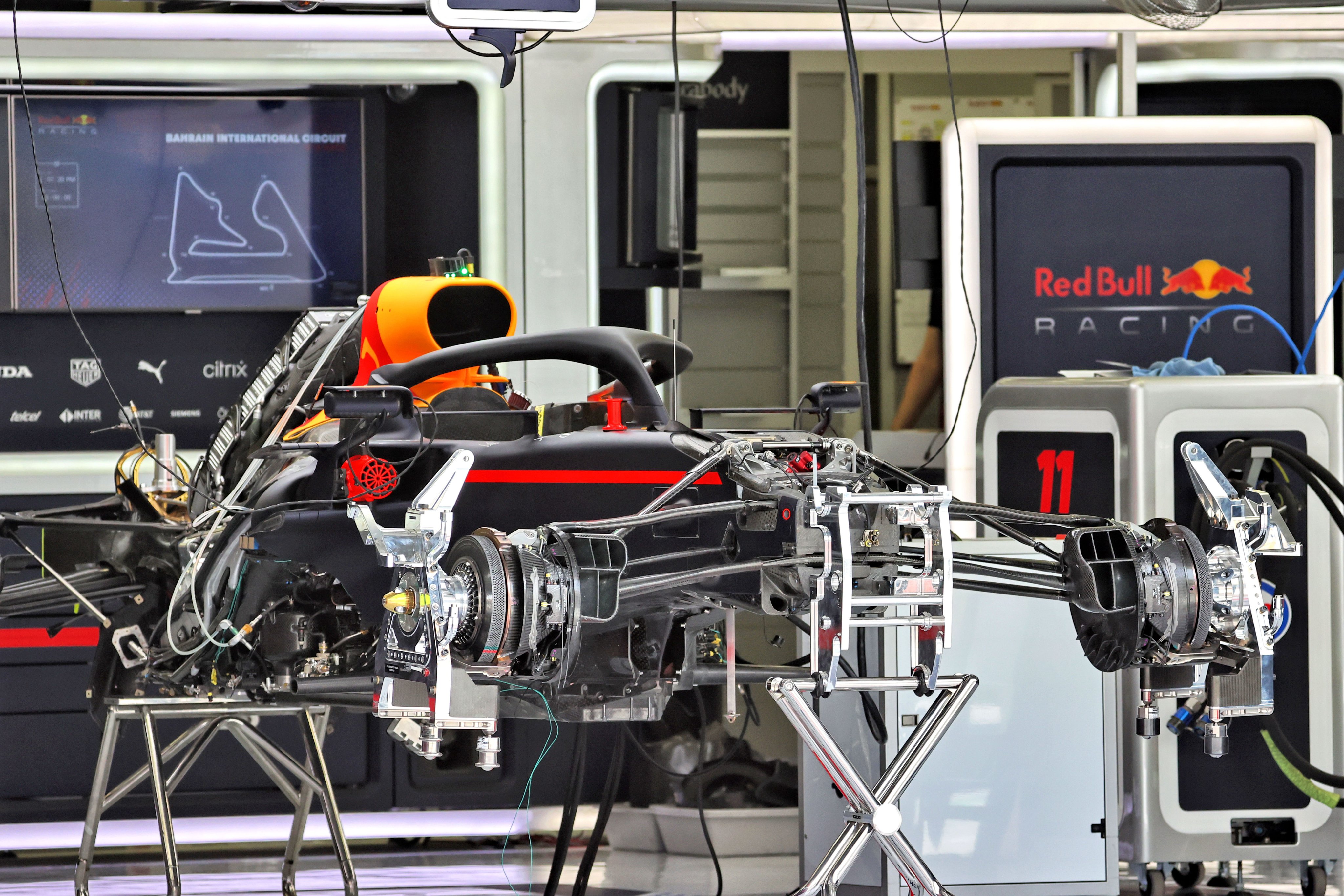

Morteza wrote:
25 Mar 2021, 12:40
https://pbs.twimg.com/media/ExUaSnPW8AA ... =4096x4096
Via @f1debrief
Interesting how the brake ducts exit before the brake rotors, whereas Mercedes has them ducted over the rotor. Does RBR want to heat the air in that area with the brake rotor? It could be that Mercedes heats the tube that passes over the rotor, and retains that heat in order to change the temperature of the air. Whereas RBR is venting the brake rotor heat directly mixed with the free stream air.

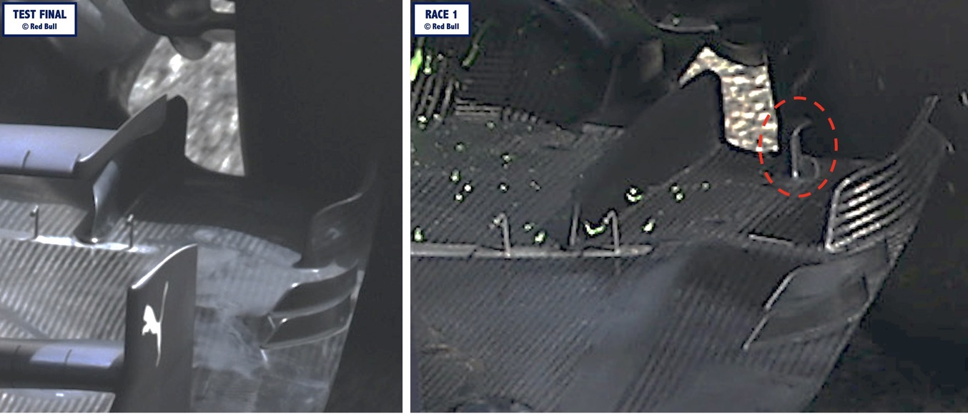

Further floor fence added this weekend
