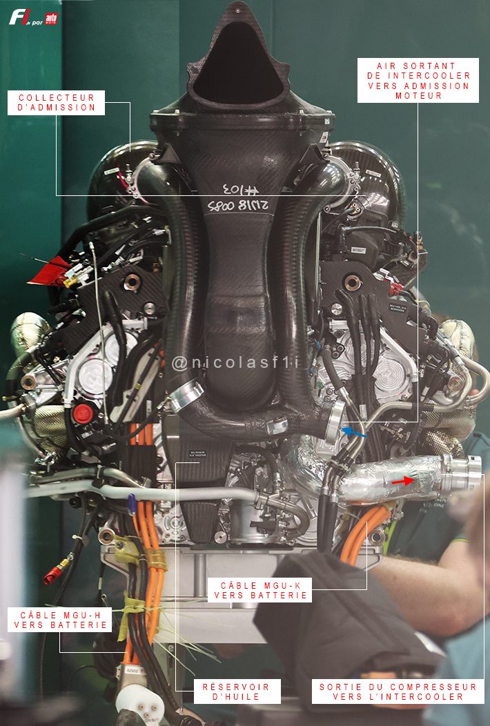

Re: Mercedes Power Unit Hardware & Software
Very Nice Mr.Motta.
Very nice. Somw good spy-work there.
So no more hairpin shaped intake runners. They went with a scroll-type? Possibly cross-flow?
I can see how a more direct flow means better pulse tuning.
And I can see additional space freed up on top of the engine at the expense of the bulges.
Charge pipe diameter also looks smaller?
