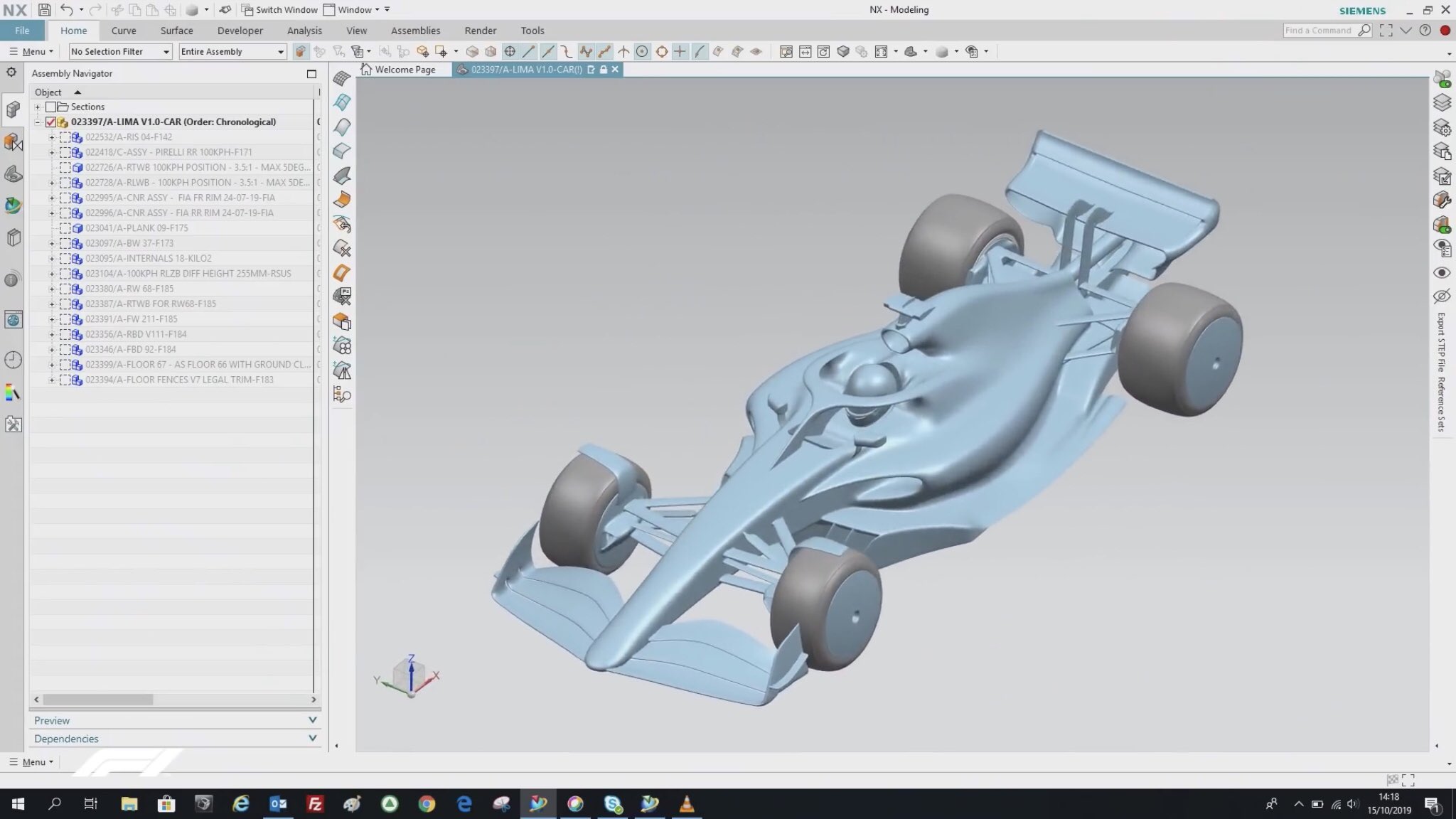

Is that me or is the area where bodywork may be (blue part behind drivers back) is bigger than this year? Fantastic article!! That's what this forum is all about :mrgreen:

Thanks, I'm trying to think of more to write about on this sort of topic. Seems to be something people have responded to.
You mean this? The engine cover bit is 700mm wide for the 2021 car and 900mm wide for the 2022 car. The length of it is about the same but the top is a bit shallower.
You can really see how the 2022 rules make this though.
