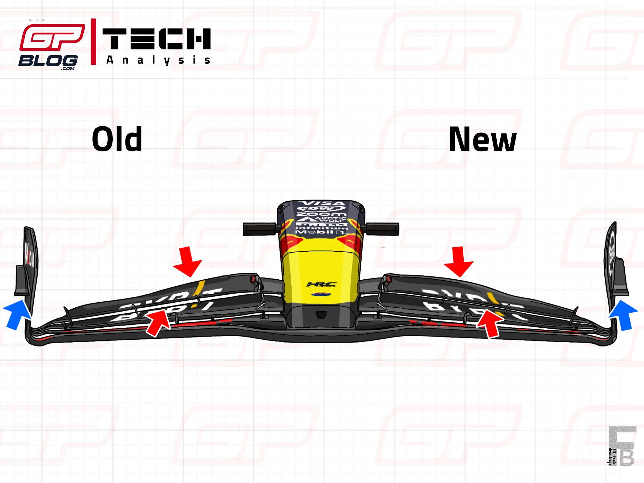

What is the function of that central v-cut on the trailing edge of top flap?
