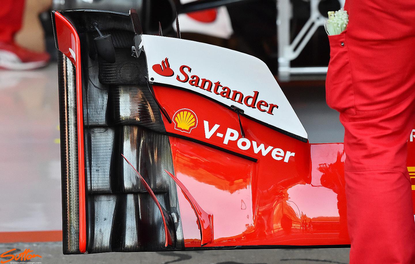

That wing is the evidence that the Y250 vortex is very important for the cars. Why else would they keep the inner edge that high to create this vortex

Based in the below photo, the mainplane and outer wing elements are the same as the current 'standard downforce' front wing. The radical looking single plane upper flap replaces the usual double plane flap, the cascades are removed and add an additional turning vane where ther cascades usually reside:

It actually doesn't look "radical" to me. It looks exactly like what McLaren spent many years running a few years ago before dramatically changing direction on their front wing philosophy. Maybe they weren't so wrong after all.

I think the old sidepods do have less drag. The smoother profile with reduced (especially abrupt) angle changes would generally equal to a lower Cd (coefficient of drag). That new front wing is quite interesting. I'm generally surprised that they don't have any seperation issues on it due to reducing the number of flaps by one and having quite a large angle change. That flap does seem fairly heavily cambered though (heavily cambered compared to other F1 front wing flaps in that position).
