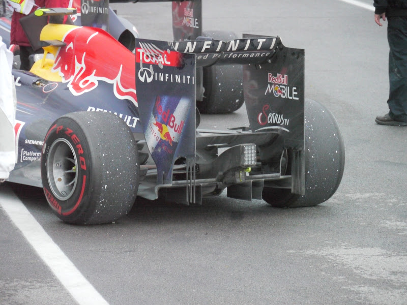

Hey guys, got some sweet pics from this weekend
Some really cool flow lines from all the dirt on both cars
(sorry for the quantity, I just held the shutter down and went crazy, you can see all my Canada Post Race Picshere

That's better than flow vis ;) Nice pictures, thanks for sharing :)

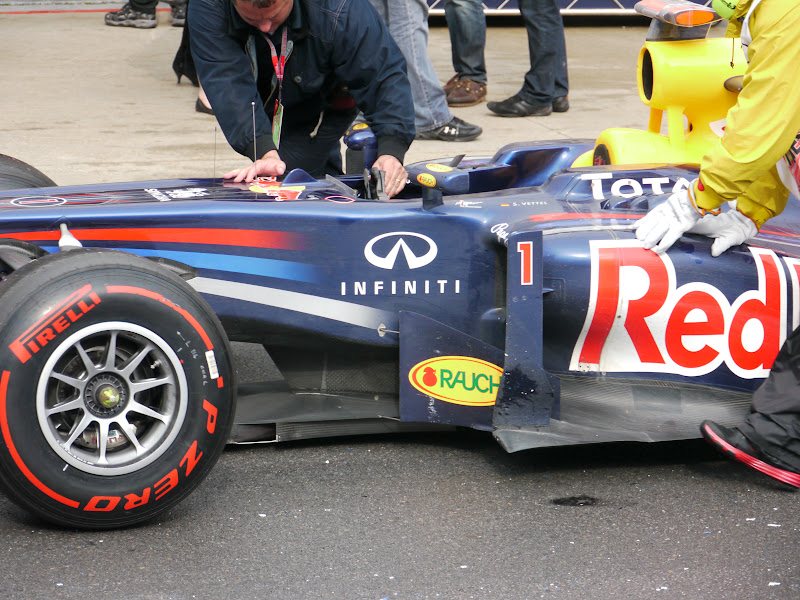

Is the misalignment between the nose and chassis at their interface a trick of light or the livery? It's present in several pictures.
PS yes thanks v much for the pics ;)

The nose is on correctly as the other stripes lineup, although there is an odd ripple in the blue and white stripes ahead of the nose mounting plain. Maybe a decal (vinyl) is separating/lifting.

yea, i noticed that too when i first looked through them, didn't really think much of it, probably just the reflection of the light (or some one made a mistake...)

If the surface is as designed and manufactured, then the reflection is indicating an odd transition from the nose corner radius to the chassis corner radius.

I zoomed in on the pic and found that the horns on the nose cone are only extruded upwards, the ones on the tub are extruded upwards and a bit to the side, thats why its a bit sketchy there.
