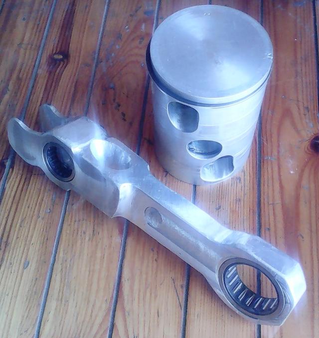

The Opposed Piston PatATi prototype engine (youtube video at https://www.youtube.com/watch?v=aXvRaVqiHxs )
is “realized in metal” and works on gasoline.
To modify it from PatATi to PatATeco (previous posts) all you have to do is to turn the injectors to inject towards the piston crowns and to lubricate independently the bearings of the crankshafts.
800cc,
80mm bore,
80mm stroke (combined stroke: 80+80=160mm)
asymmetrical intake (without reed valves or disk valves),
asymmetrical transfer,
compact / fatty combustion chamber (loop scavenging),
perfectly balanced,
etc.
Here are a few photos of it.
