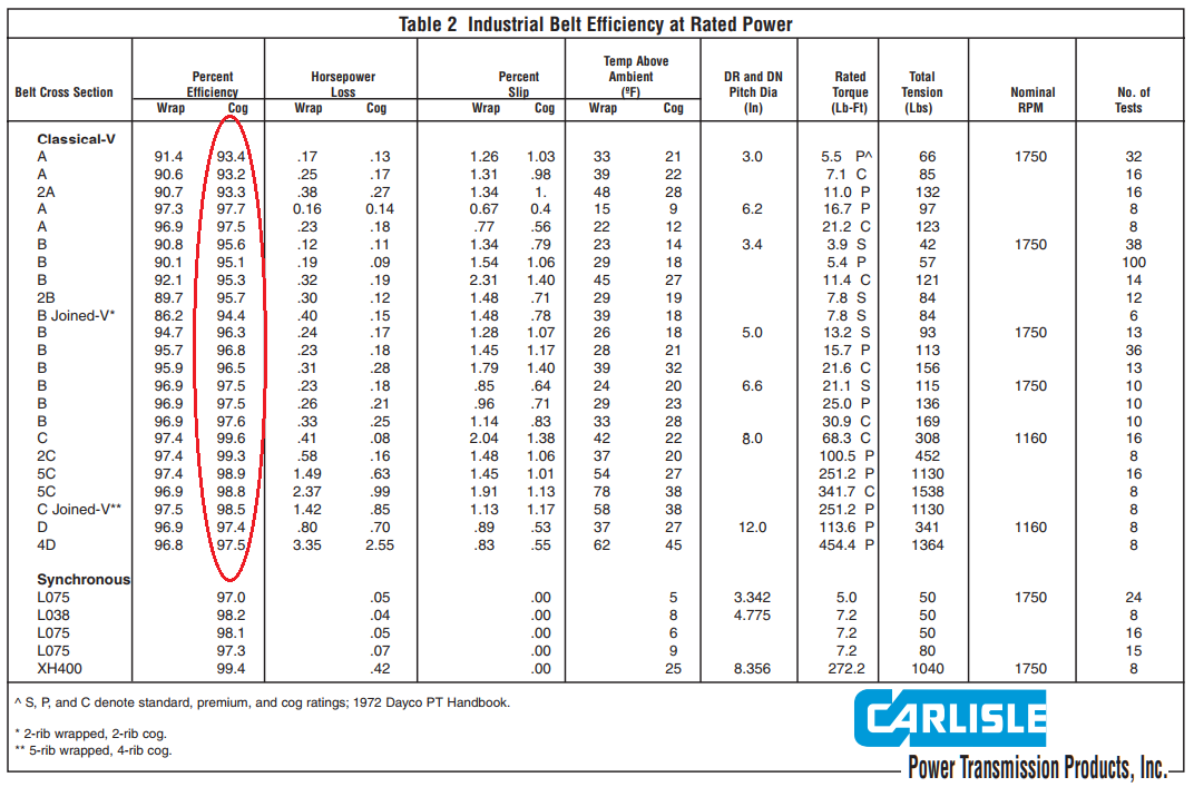

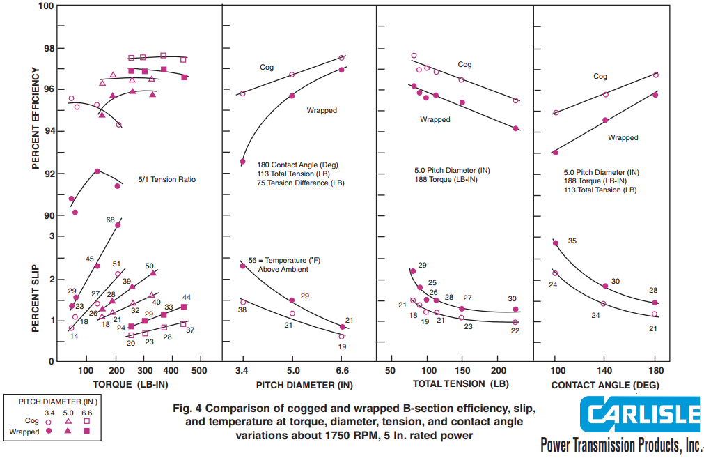

According the official tests of the Carlisle,
(more at http://www.pattakon.com/PatBox/energy_l ... ciency.pdf )
the efficiency of power transmission belts is not as low as most people used to think.
The efficiency of an industrial cogged V-belt at rated power plays around 96% (with the maximum being well above it).
The V-belt for the PatBox CVT has not significant reasons (EDIT: others than the narrower angle of the conical pulley) for being less efficient than the industrial V-belts of the above mentioned tests of the Carlisle.
The simple-minded approach is that using a cogged V-belt having something like 95% efficiency (see the above plots and tables),

haven't you highlighted the efficiencies of various belts that are in different ways unuseable in CVT ie notably the cog types ?
the CVT-suitable wrap type belts seem to be 90-91% efficient

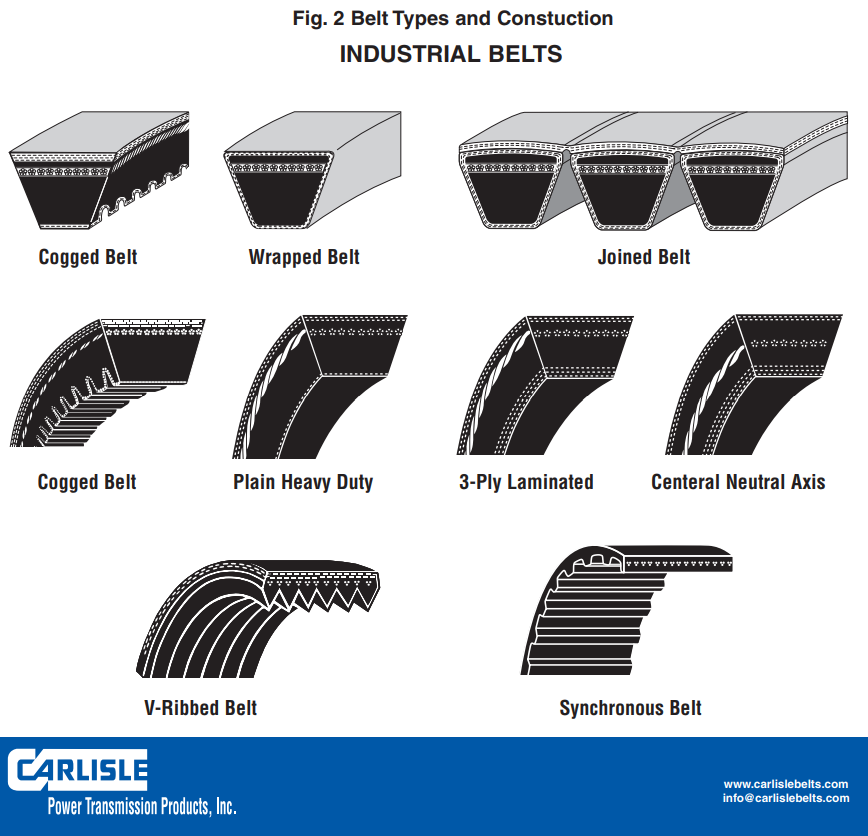

"haven't you ringed in red efficiencies of types of belt and modes of use ?? ('cog') that can't be used in CVT ?"
I think there is a missunderstanding here: the cogged V-belts are different than the toothed belts. In a cogged belt the "cuts" are not teeth; they are threre to make the belt more flexible.
Cogged V-belts are typical in conventional scooter (and sled) CVT's.
Here is a photo of the cogged V-belt used in the CVT of the Suzuki Burgman 400 (it is a normal CVT controlled by a conventional "centrifugal" variator / governot; it is different than the electronically controlled SECVTof the Suzuki Burgman 650).
It can be regarded as a “double cogged” belt (the cuts are at both sides (internal and external) of the belt).
Quote from the pdf of Carlisle :
"Bending hysteresis is the principal factor determining power loss comparisons between cross sections.
Consequently, due to increased flexibility over plain base belts industrial V-belt cogged constructions require the least energy and run at lower temperatures under no load.
Reduced cogged hysteresis is reflected by the lower temperature, although enhanced heat transfer from tooth
turbulence and greater convective area is an additional factor."

though partly because other sources use the approved term 'notched' for what is here being called 'cogged'
and your catalogue source showing cogged belts as having reinforcing cords in the teeth ie as a belt for synchronous use
and some of what you ringed seems to be rather wide ie 'joined' belts that cannot be used here

EDIT ok notched/cogged is typically claimed to be worth about 2% efficiency over wrapped
but your high efficiencies shown come from having large pulley size, high speed, and high power (ie using the belt at full capacity)
so this application won't yield these high efficiencies to the non-ehthusiast customer (the same reason I didn't buy a NuVinci)

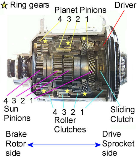

Here is the Alfine IGH of Shimano (which is not a CVT) :
Its complication (just imagine the work the shaft in the lower photo needs) justifies the 400, or so, Euros of its price (no matter how strange it appears a bicycle having a HUB gearbox costing 400 Euros!)
And what it offers? Just 11 gear ratios, and an average efficiency of some 92%.
