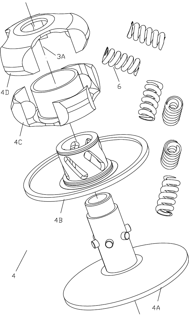

Lately we have been involved / meshed with another project, the PatEf:

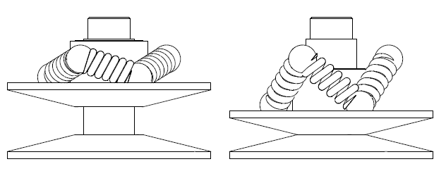

In Fig. 1 a V-belt CVT is shown at a short transmission ratio (drive shaft: 1, drive pulley: 2, driven shaft: 3, driven pulley: 4, V-belt: 5).
The torque M provided by the drive shaft 1 loads the V-belt by a force F=M/R2, wherein R2 is the radius at which the V-belt runs on the drive pulley 2.
In order to avoid "belt slippage" in the drive pulley, a minimum clamping of the V-belt between the two conical halves of the drive pulley 2 is required.
The same for the rear pulley: a minimum clamping is required, otherwise the pulley cannot apply the required force on the V-belt.
In Fig. 2 the transmission ratio (defined as the ratio of the angular velocity of the driven pulley 4 to the angular velocity of the drive pulley 2) is long, about double than in Fig. 1.
With the same torque M provided by the drive shaft 1, the substantially bigger radius R2' the V-belt runs on the drive pulley 2 reduces substantially the force F' loading the V-belt (F'/F=R2/R2') and proportionally the required clamping of the belt between the two conical halves of the drive pulley 2, and similarly it reduces proportionally the required clamping of the V-belt between the two conical halves of the driven pulley 4.

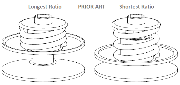

However, as shown in the following drawing, the driven pulley spring of a conventional CVT is heavily over-compressed at the longer transmission ratios.
While the efficiency (i.e. the ratio of the output power to the input power) of a conventional V-belt CVT peaks, at the shorter transmission ratios and the heavier loads, even above 95%, the efficiency drops well below 85% at the longer transmission ratios (overdrive) and the lighter loads.
The low efficiency of the conventional V-belt CVT at the long transmission ratios comes from its architecture according which: a variator (or governor) at the drive pulley pushes its two halves close to each other, while a spring in the driven pulley is resisting and is forcing the two halves of the drive pulley away from each other.

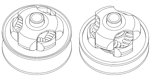

And here is the principle according which the PatEf operates:

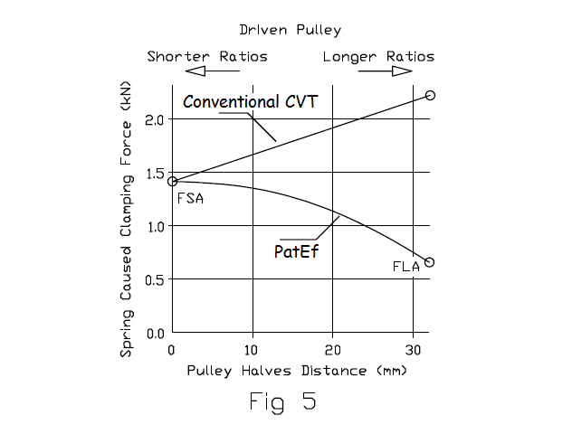

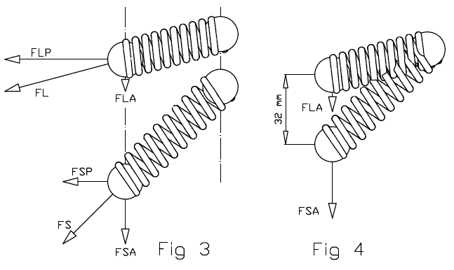

In Fig. 3 as the spring is more compressed, the force (FS, FL) it applies along its direction increases: FL>FS (the L stands for longer ratios, the S stands for shorter ratios).
Analyzing the total force FL in an axial component force FLA parallel to the rotation axis 3A of the driven shaft 3 (the A in the FLA stands for axial) and in a perpendicular component force FLP on a plane perpendicular to the rotations axis 3A (the P in the FLP stands for perpendicular), and similarly for the FS which is analyzed in an axial component force FSA (parallel to the rotation axis 3A) and in a perpendicular component force FSP (on a plane perpendicular (normal) to the rotation axis 3A), despite the increase of the total force the spring applies at the longer ratios (because it is further compressed), the axial component of the force can reduce substantially at the longer transmission ratios (and proportionally can reduce the clamping of the V-belt), as the following plot shows:

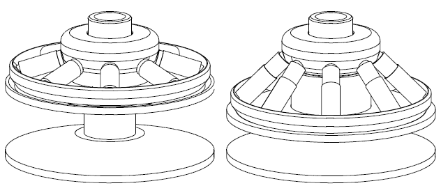

The arrangement of the springs is such that, while for higher and higher transmission ratios the springs are more and more compressed (providing a stronger and stronger force), the axial forces the springs apply on the two halves of the driven pulley (and the clamping of the V-belt these forces cause) is reduced.
The above plot shows the "spring caused clamping" versus the distance between the two halves of the driven pulley for a conventional CVT and for a CVT having the PatEf (to be noted: at 0mm distance, the two halves are at the closest to each other position, which means the V-belt is running at the maximum diameter in the driven pulley).

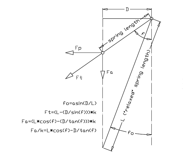

The above drawing shows the arrangement of a spring (actually of the axis of a spring) of the PatEf.
The relaxed length of the spring (i.e. the length of the spring when it is unloaded) is L, and its projection on a horizontal axis has constant length D due to its arrangement.
The axis of the spring has an inclination f relative to the rotation axis of the driven pulley (the rotation axis of the driven pulley is not shown, but it is parallel to the dashed-dot lines of Fig 31).
The total force provided by the spring is Ft along the spring "axis", with:
Ft=(L-(D/sin(f)))*k, wherein k is the stiffness of the spring.
The axial component of the Ft is Fa, with:
Fa=(L*cos(f)-(D/tan(f)))*k

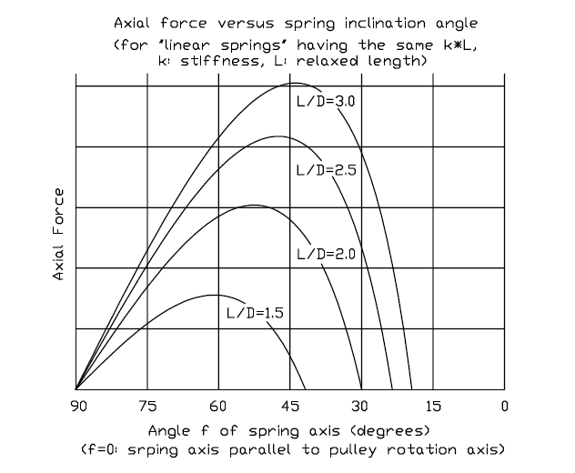

In the following plot it is shown the resulting axial force versus the spring inclination angle of the arrangement in the above drawing, for springs having various lengths.
For the specific plot (but not obligatory) the stiffness k of each spring is taken reverse proportional to its length, which means constant k*L (to make springs of constant k*L one could use the same wire, the same coil diameter and the same pitch).
Following the curve "L/D=2.5", one can see that the resulting axial force is zero until f=23.5 degrees (relaxed spring, asin(1/2.5)=23.5 degrees). Then the spring is progressively compressed.
Until f=48 degrees the axial force increases with the compression of the spring (but not linearly).
After the 48 degrees (at which the curve "L/D=2.5" maximizes), while the further increase of the angle f of the spring axis causes the further compression of the spring (because its effective length reduces), the resulting axial force reduces.
From 60 to 90 degrees (at 90 degrees the resulting axial force gets zero) the drop of the axial force varies, more or less, linearly with the angle f.
For instance, designing the driven pulley and its springs so that at the shortest transmission ratio (i.e. completely closed driven pulley and V-belt runsing at the maximum diameter on the driven pulley) the spring inclination to be f=53 degrees, and at the longest transmission ratio (i.e. completely open driven pulley and V-belt running at the minimum diameter on the driven pulley) the spring inclination to be f=75 degrees ("Axail force vs Spring inclination angle" plot), the resulting axial force (and the clamping it causes on the V-belt) reduces progressively and substantially as the transmission ratio increases.
The resulting axial force (and the clamping it causes) at the longest transmission ratio is nearly 50% of what it is at the shortest transmission ratio.
The 50% reduction of the clamping force at the longest transmission ratio fits well with what the Figs. 1 and 2 show.

If the driven pulley of a scooter CVT is modified to PatEf, the ramps and the roller weights of the variator have also to be modified to fit with the substantially different clamping of the V-belt along the operating range.
After the modification, the scooter (or vehicle in general):

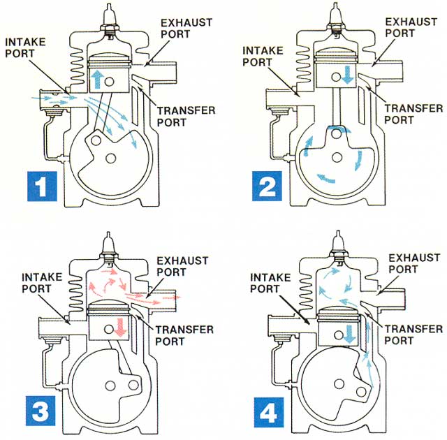

The exhaust port opens early, otherwise the crankcase, when the piston opens the transfer port, will fill with burnt gas.
After the end of the transfer, the still wide open exhaust port provides a "free way" to the fresh mixture to escape. Say as the Atkinson - Miller cycle does in the 4-strokes, but here anything that leaves the cylinder is lost and pollutes.
At the end of the exhaust, a good part of the entered air or air-fuel-mixture is not in the cylinder, and the torque drops dramatically.
And here is how things work in the PatATE:
The exhaust can open later; the rate the exhaust opens is substantially higher than in a conventional allowing the faster blow-down even with substantially later exhaust opening.

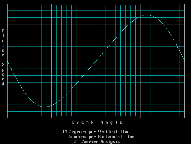

In the following plot (Piston Speed versus Crank Angle):
the piston speed at 15 degrees after the TDC is less than 1/3 of the maximum piston speed at middle stroke.
No matter what, the inertia of the exhaust helps substantially the filling of the cylinder.
During the overlap, the inertia of the gas in the exhaust creates a vacuum that suctions, through the opening intake valves, air /mixture accelerating it.
When the exhaust valves finally close (15deg ATDC), the air / mixture coming from the intake finds the exhaust closed and a still slow moving piston.
The inertia of the “intake column” increases the pressure just before the intake valves and inside the cylinder (the kinetic energy of the “intake column” turns to “dynamic energy”).
And as the piston accelerates towards the BDC the pressure drops and the speed of the air / mixture from the intake valves increases.
Despitethe fact that the exhaust and the intake were “met” for only 30 degrees (and with a substantially low average valve lift during the 30 degrees of the overlap), the job was done by turning the velocity to pressure and back to velocity.
