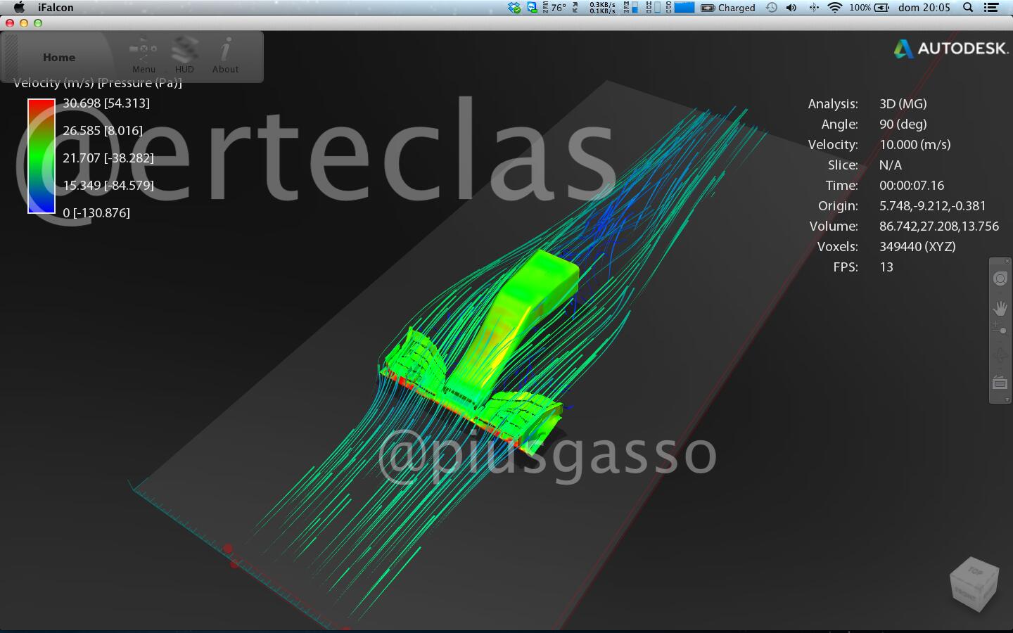

and thisFrukostScones wrote:members made CFD analysis of various nose types, this tye of nose didN't seem to be perfect, but Ferrari will have a reason (a good one?) to use it.
and thisF1NAC wrote:I am sure that guys at Maranello know what is the best version to fit on the car. Maybe they will recover the lack of the air with inwash FW?
some common sense... =D>Cuky wrote:Yeah, they did. But nobody (except Ferrari ofc) made CFD analysis of a whole car, together with tires, suspension, interior aerodynamics and with absolutely correct measures.
And I am 100% sure that guys at Maranello haven't just put that nose on and said: "that's fine, we'll go with it". I think there were months and months spent on fine-tuning nose shape, wing shape, pillars,...
Just because someone's CFD analysis of nosecone only without any other part of the car taken into consideration gave bad results doesn't make that design wrong.

What is lacking?wesley123 wrote: How so? I'm really failing to see what is missing or what is lacking.
Never trust a CFD of a front wing that produces no Y250 vortex. Or that has a color palette scaled (in velocity) from zero to whatever. Or that has wind at 36Km/h. Just sayin'.
