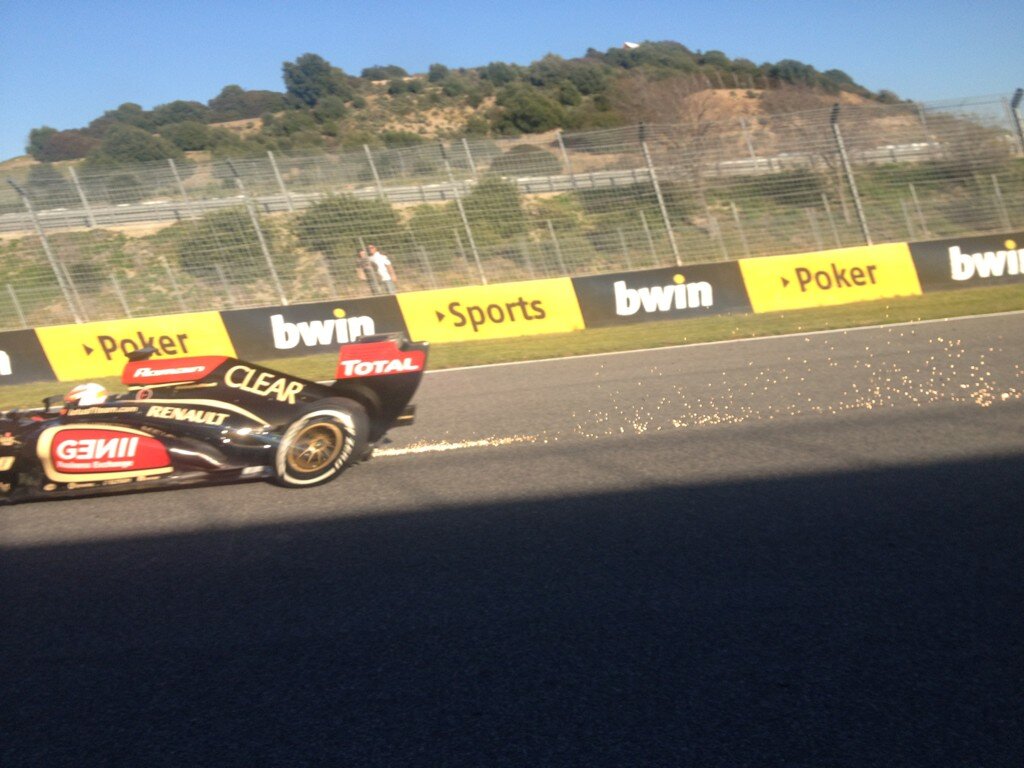

E21 bottoming out. Again, the same as E20 was doing during most of the year.
Fernando Alonso is the best pay-to-drive driver in F1 with the biggest amount of money behind him.

MarkedOne8 wrote:E21 bottoming out. Again, the same as E20 was doing during most of the year.
why is it??? been wondering the same.

Mostly, the aim is to have as lower as possible plank to get better aero performances in corners but without bottoming out because that reduces the top speed due to increased friction. Lotus is using either to low ride height or to soft springs.
