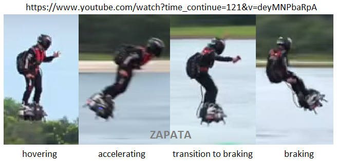

At the middle of page 202 of this discussion it is a video showing Franky Zapata accelerating - decelerating with his FlyBoardAir JetPack.
The following image:
was made using slides from that video.
Compare with:
Thanks
Manolis Pattakos

Rodak
Rodak
37
Joined: 04 Oct 2017, 03:02
manolis wrote:
20 Jun 2020, 07:17
Hello Rodak.
https://www.pattakon.com/Fly_files/ZAPATA_Acc_Dec.png
Compare with:
https://www.pattakon.com/GoFly/Portable ... _small.png
Thanks
Manolis Pattakos
The pictures of the flyboard are not relevant to your system. Show how YOUR flyer would transition from fast flight to braking mode. Please show how the pilot would maintain his attitude in braking mode and why he would not just weather cock back into flight position if there was forward speed. You can't have it both ways; either the body of the pilot provides lift and acts as a wing or it doesn't. If it does I don't see any way to get into a stable braking position. If it doesn't ...... As I mentioned, to achieve the braking position the flyer, from what you show, has to go through a zero speed condition which means there is no need to brake......

manolis
manolis
107
Joined: 18 Mar 2014, 10:00
Hello Rodak
You write:
"The pictures of the flyboard are not relevant to your system."
The pictures are as relevant as it gets.
They show how Zapata vectors the trust to the desirable direction in order to hover, or to accelerate, or to decelerate.
The pilot of the Portable Flyer does the same: the thrust is vectored to the desirable direction in order to hover, or to accelerate, or to decelerate.
In the one case the power unit is under the feet of the pilot, in the other case the power unit is above the head of the pilot.
Spot on the direction of the thrust in the case of Zapata and in the case of the Portable Flyer, during hovering, during acceleration and during deceleration.
Do you see any difference?
You also write:
“Please show how the pilot would maintain his attitude in braking mode and why he would not just weather cock back into flight position if there was forward speed.”
Attitude or altitude?
And why to keep his altitude at braking?
Think how the motorcycles at the moto-GP decelate / brake before a turn.
The rider just rises his upper body and the aerodynamic resistance does most of the braking.
If necessary, he brakes with the normal brakes, too.
You also wite:
“ You can't have it both ways; either the body of the pilot provides lift and acts as a wing or it doesn't.”
You can have it both ways.
Because the human body is flexible and the human brain is a great controller.
Enjoy once more the following video and think if they “have it both ways”:
The skydivers can accelerate and decelerate / brake and then accelerate again and so on (their speed varies between, say, 150Km/h to 350Km/h), they can also move sidewise (into some limits).
But the skydivers cannot help moving downwards, while the Portable Flyer can move at all directions.
