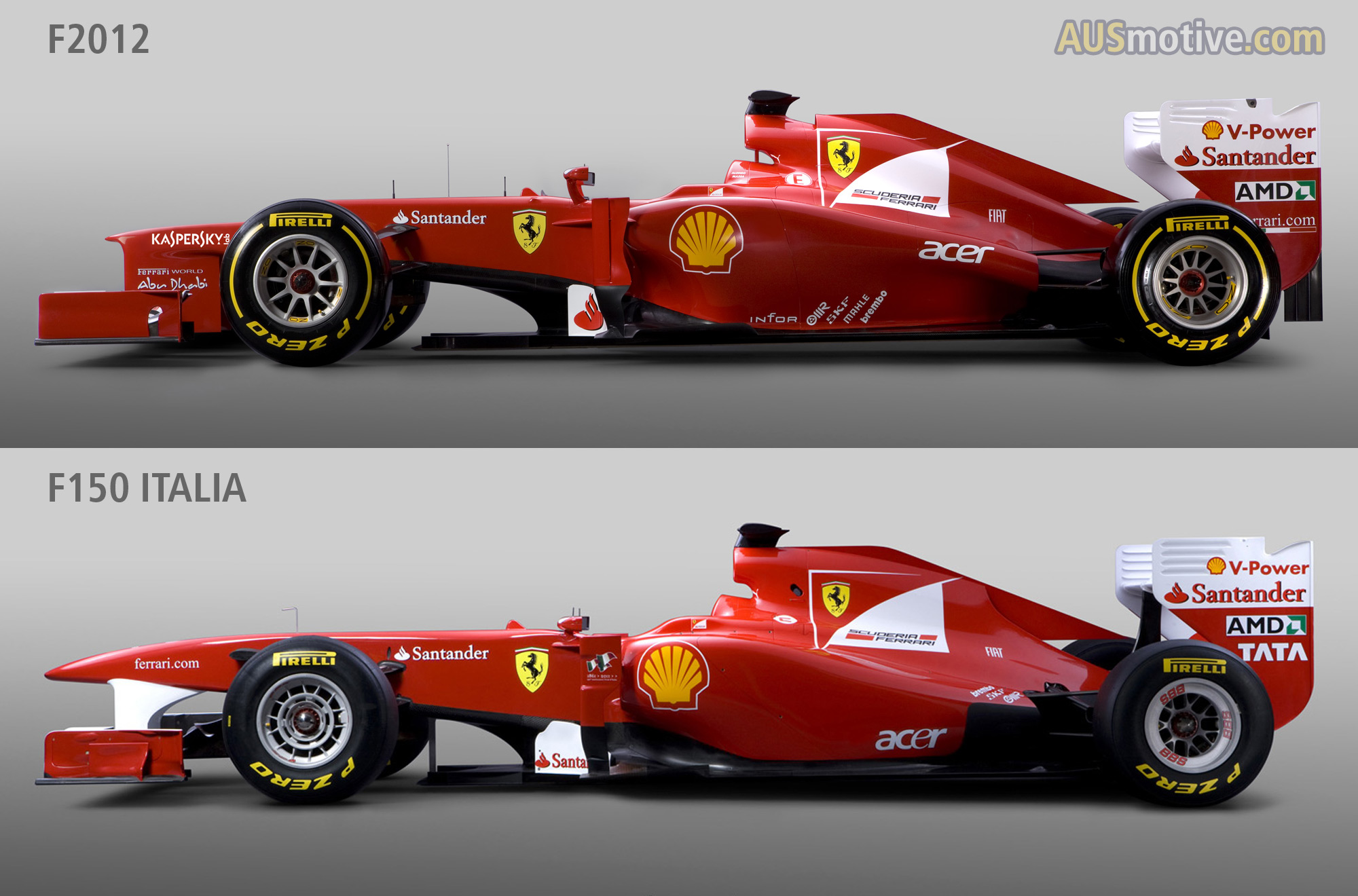

don't know if already mentioned before in this post, but the nose tip in the F2012 is clearly behind the front wing leading edge: I think it's a first on recent F1 cars, what aero gains should this solution provide ?
Drivers should also be more careful during battles, especially not to hit from the back the car in front: with this solution they would definitely damage the front wing, while with the "long nose" if they are lucky they can get along with only a scratched nose tip...

its not so much that the nose is shorter in length..it has little difference from last year's nose..the fw is moved forward because the wheels are also moved forward due to different suspension arm angles...

The nose cone is so short because of the height of the underside. Any londer a nose cone and it would have a wafer thin cross section hanging over the front wing.

Sorry if already posted, but I just found this awesome tool for comparing the F2012 to the F150. Drag the sliders for direct comparison photos:
http://www.marca.com/2012/02/03/multime ... 88095.html

The scale is off though. This is a better one:
http://mclarenf-1.com/index.php?page=srch&ch1=23&ch2=2

Both are flawed to the point of uselessness because the pictures aren't taken from the same angle and distance.

raymondu999 wrote:The scale is off though. This is a better one:
If that is a true comparison, how come the 2012 nose is no lower than the 2011 nose?

gilgen wrote:If that is a true comparison, how come the 2012 nose is no lower than the 2011 nose?
The front view is way off. The side view is better.
The F2012 nose is certainly lower than the 150 Italia, whether that comparison is correct or not. Here is said site and it looks lower to me.
