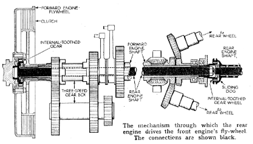

Hello Tommy Cookers.
You write:
Quote from https://www.forza-mag.com/issues/154/ar ... ity-clause
Alfa Romeo Bimotore 1935
Some more details:
All this "complexity" was necessary in order to utilize two long engines: an in-line 8-cylinder engine in front of the driver and another in-line 8-cylinder engine behind the driver, with a common gearbox / differential at the middle of the car (the drive wheels were the rear wheels).
I can't see how this architecture affects the inertia torque on the engine casing.
You also write:
  • the point of the Mercedes axle is that each wheel/road contact load is unaffected by the engine power being used
Sorry but, again, I can’t get how the Mercedes axle eliminates the inertia torque on the engine casing and on the frame of the car.
A drawing / plot / photo would help.
Thanks
Manolis Pattakos

regarding the Mercedes-style axle (eg in the Bimotore) ....
the axle is unrelated to the twin engines - it was used earlier (as I said) in the Tipo B cars
the twin CWPs appeared in 1914 in what was the first Mercedes GP propshaft-driven axle (1913 M GPs used chain drive)
the twin CWPs were (then) apparently to allow (positive) camber to match perfectly the road camber
we can still wonder what (the honorary Dr and onetime Merc TD) Porsche did for the Mercedes axle design pre 1924
my view (on the axle's USP) came iirc (via sources eg Pomeroy, Clutton ?, and Karslake) from the Posthumous book
eg Pomeroy's book has only the 1914 car
btw Mercedes and Benz nominally had some co-operation from 1924 but actually merged in 1926

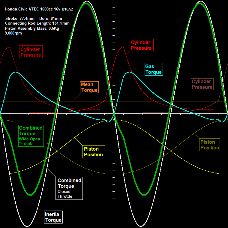

Hello Zynerji
You write:
  • "Doesn't the MGU-K do this in F1 now? I always thought the K would go into "recovery" mode at certain parts of rotation to counteract these harmonics..."
    and
    "Honda said theirs switched 40Hz. Is that really too slow to have this effect? Maybe I'm remembering the MGUH numbers..."
The plot at the top of the last page:
explains the case.
The gas torque (cyan curve), i.e. the (per crank rotation) mechanical energy provided to the set of the four pistons by the working gas, is seven times (or so) smaller than the inertia torque (white curve), i.e. seven times smaller than the (idling) mechanical energy oscillating between the set of the four pistons and the crankshaft / flywheel / transmission / drive wheels.
Subtracting the gas torque from the inertia torque, it results the combined torque (green curve). The green and white curves are similar in size and shape (i.e. the "counteraction" from the gas is too small).
As for the mechanical energy that can be "milked" from the exhaust gas, it is smaller than the mechanical energy provided by the gas to the pistons.
Regarding the frequency:
At 9,000rpm (i.e. at 9,000/60=150 crank rotations per second, i.e. at 150Hz) where the 1600cc four-cylinder engine operates in the video, the frequency of the inertia torque is 2*150Hz=300Hz.
So, it is not only that the energy contained in the gas (and in the exhaust gas) is too small to seriously counteract (somehow) the inertia torque, but it is also that the required frequency of the "counteraction" is too high to be impemented by some kind of "MGU-K".
Thanks
Manolis Pattakos
