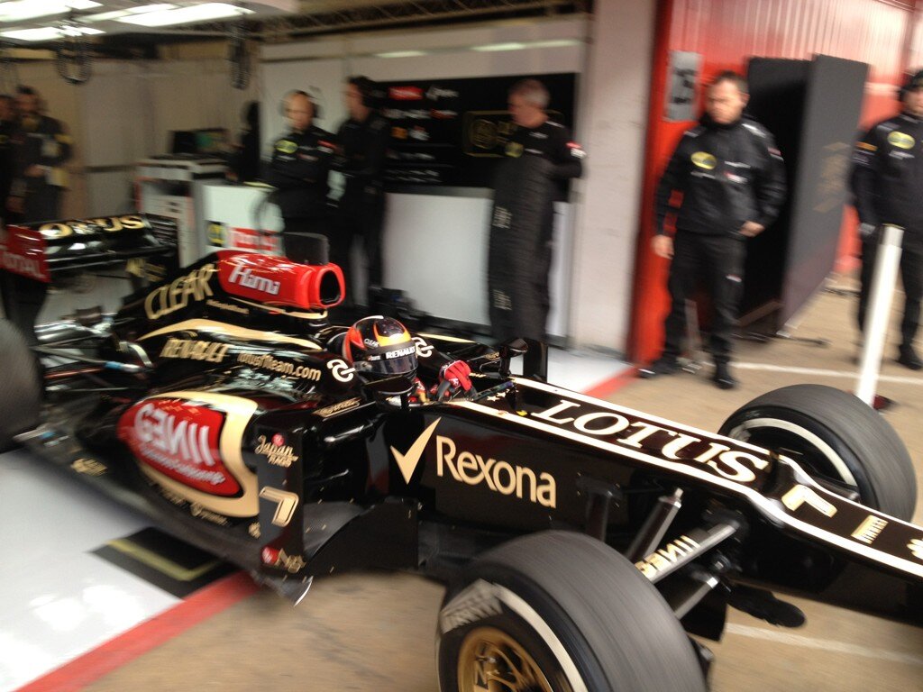

-monkey seat on the outlet: if the periscope is blowing above a certain speed when the main pipe cannot expel any more flow, why is the big monkey seat needed? In 2013 lotus have got rid of the big monkey seat, but they still need the tongue after the exit of teh main pipe to drive the fluid. If the periscope is sucking and there is a throat in the main pipe to achieve the lower pressure needed, then the monkey seat is necessary to pull the flow out from the throat
How do you know that they got rid of monkey seat? For me more sense makes the idea that they didn't have time to fit it, they were using very old (from the middle of the 2012 season) rear wing after all.
