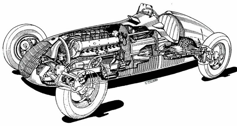

EDIT mistakenly ? now think saw V16 having (for valve and port size) the combustion chamber wider than the cylinders
fabricated construction ? - but iirc the 158-9 not so ?
NB this above probably the tipo 162 135 deg V16 Ricart (with H Ricardo consultating 62x62 1940 GP car)
not the 1938-9 tipo 316 3 litre V16 60 deg car or 1937 tipo 316
btw Italy reinvented 1.5 litre GPs - Mercedes-Benz and Auto Union ? made such cars and a 1940 GP season was started
the 1954 Formula A-R tipo 160 concept (mid-engine - driver at rear) was tested on a 158 'mule'
this photo is/was incorrectly presented on this site as tipo 160
the 160 had 4 wd 180 deg V12 and no chassis - the engine and transmission casings acted as a chassis substitute
drawn but only the engine etc built (still exists)
online there's an illustration drawing of the 160 car
