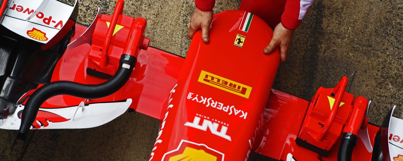

I think Allison may have left something unsaid...
"Where our front bulkhead is makes it rather difficult for us to get a nose designed to complement our particular aerodynamic concept that is super-duper short and still pass the crash test. We can go shorter than we are now, but we probably can't go as short as some of the others, but that's one of those things."
The SF15-T's nose appears to have a lower angle of incidence compared to that of the W06, for example, meaning it would probably require a nose-schlong in order to adhere to the regulations if shortened to the same degree as the W06.
If Ferrari's 2015 concept mirrors its 2014 concept, which seems to be the case, a lovepump might cause more problems than it's worth.
2014 vs 2015

That seems to me a much more precise Explanation behind their reluctantness going for a short nose.
That said I'm still not 100% comvinced the short nose is under all circumctances the better nose under the 2015 regulations...

Agreed. If the 2015 concept is the same as last year, the Ferrari nose is fine, as it creates downforce on its own through the Venturi effect imparted by airflow that passes through the "tunnel" formed by the underside of the nose, the "skirts" that flank the underside of the nose, and the center section of the wing...
...and its rounded profile on top allows air flow that might ordinarily pass over the chassis to instead spill over the sides and then toward the back of the car, which somewhat mimics the old high-nose designs.
I suspect the current design might give the car a touch of pitch sensitivity due to the dynamic nature of the gap between the underside of the nose and the track surface directly beneath it as the car pitches back and forth. But, if the team can shorten the nose so the tip is at least in line with the leading edge of the wing, thus forming a static gap between the underside of the nose and the wing directly underneath, that ought to be good enough.

Take note of where the main structure is for the suspension parts. It further upstream than the other cars. This may be due to the pull rod suspension. But you can clearly see that the springs and other components supporting the suspension is at the front where the bulk head starts to taper down, compared to the Mercedes which has it's components more centrally located.

I think that's clearly the case. To make anything drastic in nose department, they'd need to move the upper wishbone to still comply with the nose rules, and that's something you would never do midseason.

For a short nose at any cost, the solution appears to be relatively simple if you're willing to alter the aerodynamics: square off the rounded edges and allow the contours of the chassis to define its shape.
Presto! You've now got a Merc-style short nose, and the suspension is already accommodated.
Or am I missing something?
