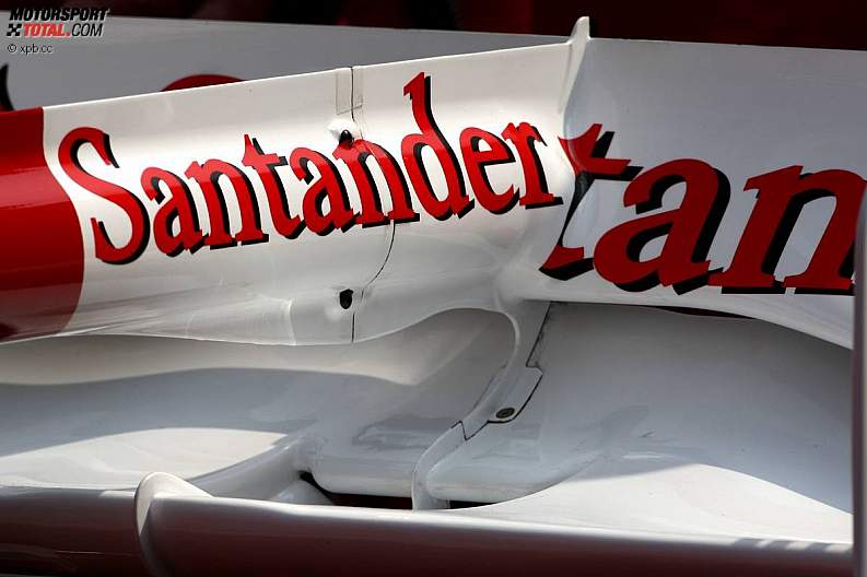

Re: Ferrari F10
autosport wrote:"The F-system was not active," he said. "We tested some parts of the engine cover and the rear wing to validate them and to check they worked fine, but the aerodynamicists will now gather data. But the system was not complete.
"I had nothing inside the cockpit because the system is not complete. We tested the engine cover to compare it with the standard one. I didn't notice anything. I guess there will some new numbers from an aero point of view."

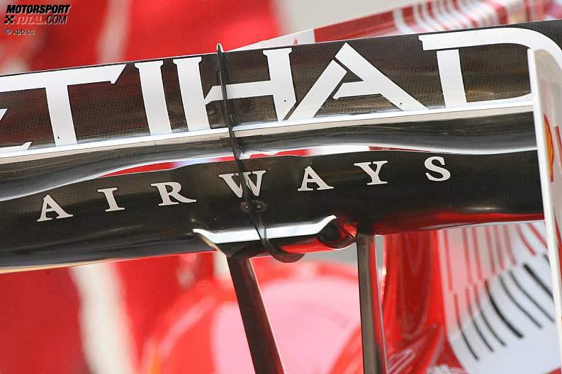

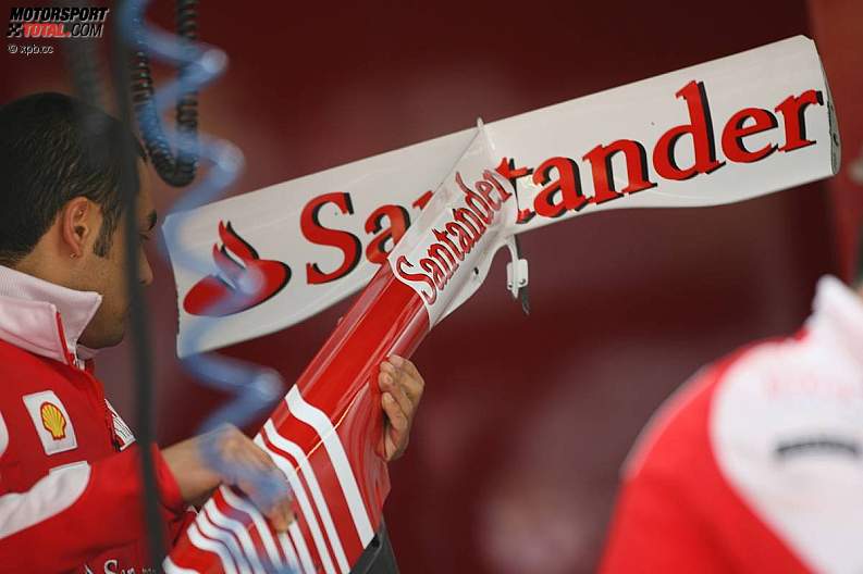

Re: Ferrari F10
I would suggest that they tested a version without driver intervention to assess the effects of stalling the wing at high speeds. Obviously, the downforce will have been compromised throughout the rest of the lap, hence the comment that the system was incomplete. They could tape up the inlet to do and A - B comparison.
Interesting in the last picture that, apart from the slot, they also added an upside-down Gurney flap further downstream - possibly to simulate a later flow separation point.
I had noted in another forum that the McLaren slot, when active, would behave like an upside-down Gurney flap. This seems to confirm that!
