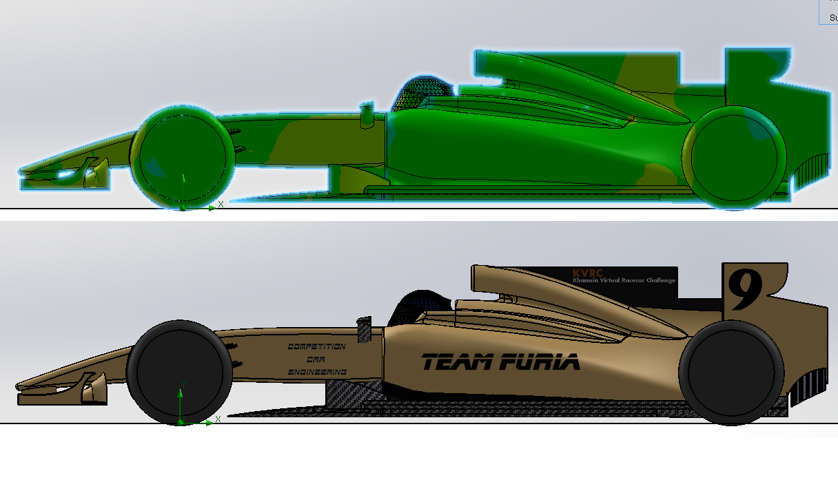

I am entering the 2014 KVRC and this is the car for the firts race.
Lots of things to optimize, but looking pretty good compared to last year.
Any comments

Very very good shape and color! Hope it will be as fast as it looks nice to see.
Are you working with SolidWorks and Flow Works? I would have many things to talk about : )

Left and right are not the same.. central air-intake as well as the mirrors?

Good point el-Mágico. They are two different spec cars left and right. The one on the right didn't meet the kvrc rules so I had to modify it. Unfortunately with no time to test it right.

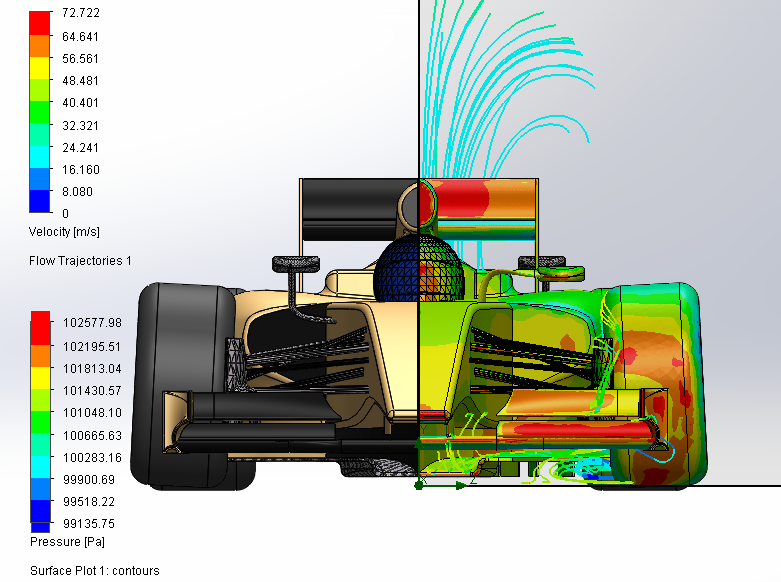

CAEdevice, 0.035 seems a little low, but depneds on the size of your smallest element. For Mónaco I used 0.1.
Now, some updates for the Magny Cours race. My car did great in drag, but had to low downforce. Also the CoP was pretty good, and I think it should stay in the same place. Updates are:
-Front Wing: New endplate, triple plane with different airfoils. Small winglets added.
-Rear Wing: New endplate, new airfoils, louvres added.
-Floor: Different expansion ratio, gurney aded, new leading edge, different distribution of strakes.
-Body: Optimized cooling intake dimensions (I was 10000mm^2 over the minimum!), optimized shape to avoid adverse pressure gradients, turning vanes added.
-Added a monkey seat to balance CoP.
And now the pictures:
And some comparisons between Monaco and Magny Cours:
As allways all coments are welcome!

So, this is the package for Monza. Again lots of changes. Floor, body, front wing, bargeboards...
The following pictures show the new spec and the relative pressure contours. Nothing hidden this time :wink:
As usually all comments are welcome!

i dont understand why the roll hoop air inlet is feeding air to the rear of the transaxle.
